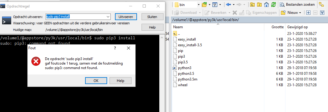

Remmert
- Posts: 5
- Joined: Thursday 23 January 2020 13:21
Re: Buienradar Weather Lookup Plugin
Something like this...
- Knipsel.PNG (47.2 KiB) Viewed 1684 times
- FireWizard
- Posts: 1968
- Location: Voorthuizen (NL)
On which platform have you Domoticz installed?
And also this question: Why do you want to install the "Buienradar" plugin, while Domoticz has native support for "Buienradar"?

- FireWizard
- Posts: 1968
Maybe, you have to install pip3 first. I have no knowledgeabout the Synology NAS,
See: http://domoticx.com/synology-nas-python ... stalleren/
Firestorm80
- Posts: 1
- Joined: Wednesday 04 March 2020 13:24
I had the same issue, it's because pip3 is not in the PATH.Remmert wrote: Thursday 23 January 2020 16:36 Hi,
Domoticz is installed on a DS214+ with Python.
Well I’m just trying to add some plug-ins to see of it works.
I already use Open Weather with an API. That works.
Maybe buienradar has some other data.
sudo python3 get-pip.py
WARNING: The scripts pip, pip3 and pip3.5 are installed in '/volume1/@appstore/py3k/usr/local/bin' which is not on PATH.
Either add that directory to the PATH or execute this statement:
sudo /volume1/@appstore/py3k/usr/local/bin/pip3 install requests
After that my Buienradar script works.
You can test commandline from the plugins\Domoticz-Buienradar by using python3 plugin.py
Should be error free now.
