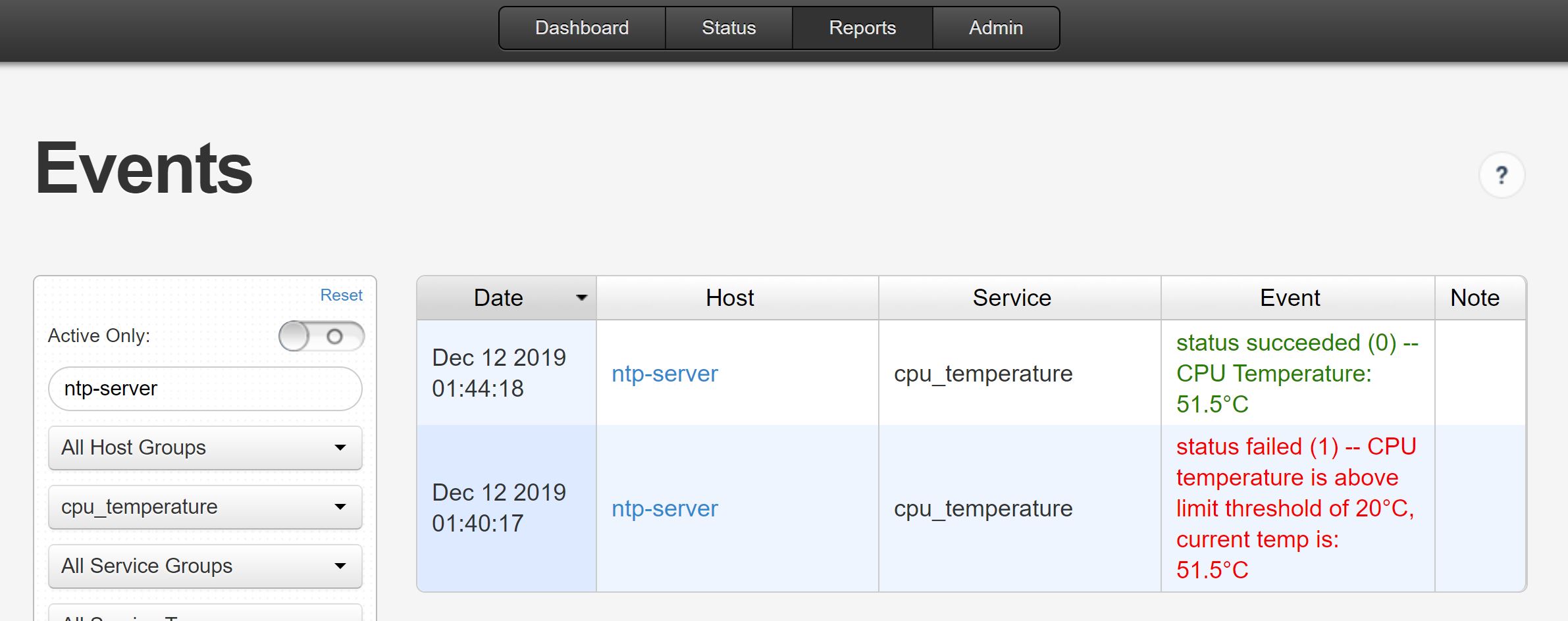

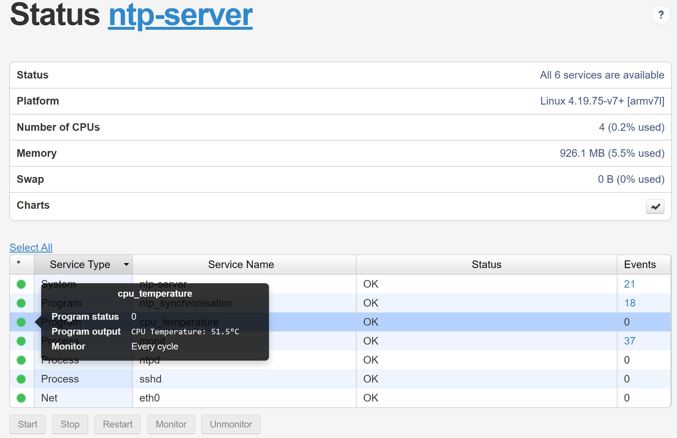

This is a script I wrote for monitoring CPU temperature in Monit / MMonit.
Features:
1) Display current temperature in MMonit (checked at each cycle defined in Monit).
2) Alert if set CPU temperature threshold is exceeded.
Requires: apt-get install bc
/etc/monit/customscripts/picputemp.sh

I had to temporarily set the threshold to 20 degrees to trigger the alert (so I could show how the MMonit log looks when its triggered):
