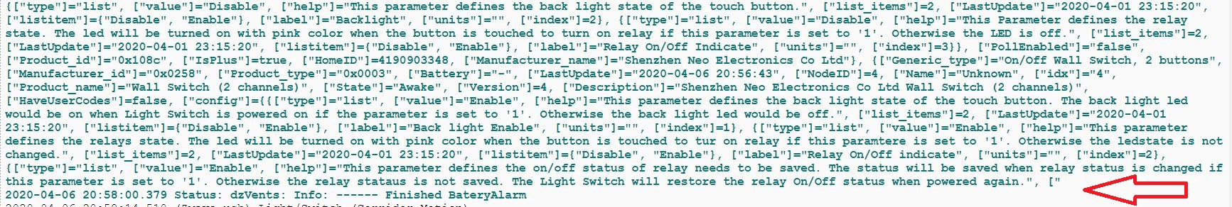

Hi I have simple one scenario but I dont know why my variable is truncated in the log
Its look like loging is on specific length
I wanted to list my all zvawe device ant when I look at the log the log is truncated. I have 12 devices but log show few of them
Simple script
   domoticz.openURL({
                    url = 'http://192.168.88.240:8080/json.htm?type=openzwavenodes&idx=2',
                    method = 'GET',
                    callback = 'data'
        if (item.isHTTPResponse and item.ok) then
            if (item.trigger == 'data') then
            local results = item.json.result
             domoticz.log(item.json.result, domoticz.LOG_INFO)
in logs you can see its truncated
000254_2020-04-06 21_00_26-Domoticz.jpg (317.28 KiB) Viewed 803 times
Re: Dzvents json.result tuncated in log  [Solved]
fr3sh wrote: Monday 06 April 2020 21:02 Hi I have simple one scenario but I dont know why my variable is truncated in the log
If you log to an os file you will see the complete log.
you can set that in /etc/init.d/domoticz.sh
with an editor of choice
DAEMON_ARGS="$DAEMON_ARGS -log /var/log/domoticz.log" # or any other OS file
DAEMON_ARGS="$DAEMON_ARGS -loglevel  normal,status,error
sudo systemctl daemon-reload
sudo service domoticz stop
sudo service domoticz start
sudo tail -f  /var/log/domoticz.log

It's little complicated then that because I have domoticz on docker ;)
But tell me the SETUP->LOG is truncating the log?

I see more logs on filesystem thank's waaren
