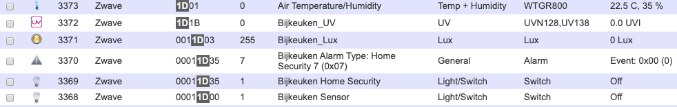

I have been running domoticz for a couple of years, and until a couple month's ago, it was all good 'n dandy. But when upgrading to OpenZwave 1.6 a lot of problems started. I have been really busy with real life / work etc, so never got around to it to fix it, but it annoyed me terribly. So i tried to fix it today .. by reinstalling domoticz from scratch using the wiki install guide. Restored my backup, and was hoping for the best. Sadly, the motion sensor of the Aeon Tech MS6 is just not working. When movement is detected, in the domoticz log i only see:
2020-03-23 22:30:00.747 Status: OpenZWave: Alarm received (Home Security: Clear), NodeID: 10 (0x0a)
Nothing about the motion sensor. I removed the MS from the controller, re-added it. It does detect everything:
Screenshot 2020-03-23 at 22.32.47.png (50.18 KiB) Viewed 1805 times
I have this issue with multiple motion sensors, and i kind of ran out of ideas. Any help would be welcome.

Try to change Command Options to "Binary Sensor Report" and reboot. that did the trick for me.

Go to hardware->zwave->multisensor. Then change option five from basic to binary.
Hope it helps you also!

This device had the ID 00000535 Unit 1 Type Light/Switch which I had named "Manipulation" after the suggested type when the device was created.
In your case this could be the "00011D35 Bijkeuken home security Light/Switch". In my case it is turned off after 5 seconds, but that is enough to catch it in a device script.
But I am not sure if this is working as designed. I have already made a post in this topic.
edit: And, as I now noticed, changing the Command Options to "Binary Sensor Report" gets me the old behaviour ( thanks @alveman)
