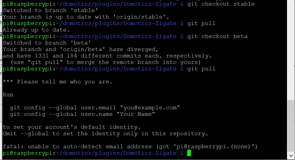

Today I updated to newest Beta version of Domoticz (V2020.1 build 11836). I read about the new versioning error in Zigate, so switched to Zigate beta branch. I did:
cd domoticz/plugins/Domoticz-Zigate
git pull
git checkout beta
Still an error in the log remains:
2020-03-26 21:52:46.917 [74b11220] Error: (Zigate Zigbee) 'onStart' failed 'ValueError':'invalid literal for int() with base 10: '1 (build 11836)''.
2020-03-26 21:52:46.917 [74b11220] Error: (Zigate Zigbee) ----> Line 833 in '/home/pi/domoticz/plugins/Domoticz-Zigate/plugin.py', function onStart
2020-03-26 21:52:46.917 [74b11220] Error: (Zigate Zigbee) ----> Line 221 in '/home/pi/domoticz/plugins/Domoticz-Zigate/plugin.py', function onStart
Weird thing also is if I do another "git pull" now in Zigate dir, I get this error:
*** Please tell me who you are.
Run
  git config --global user.email "[email protected]"
  git config --global user.name "Your Name"
to set your account's default identity.
Omit --global to set the identity only in this repository.

you need to do git pull after a git checkout beta
Geitje
Posts: 170
Joined: Monday 22 January 2018 21:52
Re: Zigate plugin error after v2020.1 update
Post by Geitje »
Thanks.
Git pull works OK in stable branch. But not in beta branch:
Aantekening 2020-03-26 224833.png (63.18 KiB) Viewed 3196 times
Zwave, Zigate, RFlink etc.
pipiche
Posts: 2049
Post by pipiche »
Please do check the following thread
https://www.domoticz.com/forum/viewtopi ... db2ce55b34

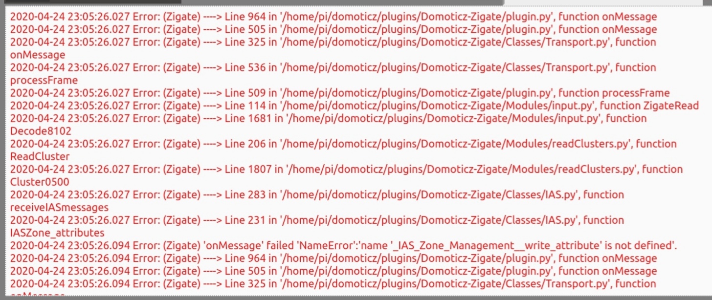

Hi, I have some errors with zigate plugin..they start yesterday when the devices doesn't work.. I fix with restart raspberry pi, but now I have the same problem after 24hours. I attach the print screen.
Domoticz v2020.1 build 11970
Zigate plugin 4.8.0.17
Domoticz on Raspberry Pi 4 Debian 13 x64
Zigbee2mqtt and zigbee devices (Xiaomi, Ikea,Tuya, Philips, Osram), Broadlink, Solar power Victron Energy, Yeelight, Xiaomi Purifier Pro, Roborock S5, Gree AC, JBL soundbar, Philips Android Tv
pipiche
Posts: 2049
Post by pipiche »
pfloryann wrote: Friday 24 April 2020 22:31 Hi, I have some errors with zigate plugin..they start yesterday when the devices doesn't work.. I fix with restart raspberry pi, but now I have the same problem after 24hours. I attach the print screen.
Please provide the full Log, only error doesn't help, as this is the consequence of something in the beginning.
As you are on plugin beta version, make sure to have the latest one

Hi I using Domoticz 2020.1 (build 11984) and plugin 4.8. 0. 18 and all at once I have this errors and in the plugin Web admin max load is too high and orange I attached an image. All zigate devices is blocked. I tried to restart the plugin from web interface but doesn't work. Only solution it was to restart the raspberry pi.
2020-05-04 00:19:02.089 Error: (Zigate) ----> Line 1810 in '/home/pi/domoticz/plugins/Domoticz-Zigate/Modules/readClusters.py', function Cluster0500
2020-05-04 00:19:02.089 Error: (Zigate) ----> Line 283 in '/home/pi/domoticz/plugins/Domoticz-Zigate/Classes/IAS.py', function receiveIASmessages
2020-05-04 00:19:02.089 Error: (Zigate) ----> Line 231 in '/home/pi/domoticz/plugins/Domoticz-Zigate/Classes/IAS.py', function IASZone_attributes
2020-05-04 00:19:02.168 Error: (Zigate) 'onMessage' failed 'NameError':'name '_IAS_Zone_Management__write_attribute' is not defined'.
2020-05-04 00:19:02.168 Error: (Zigate) ----> Line 965 in '/home/pi/domoticz/plugins/Domoticz-Zigate/plugin.py', function onMessage
2020-05-04 00:19:02.168 Error: (Zigate) ----> Line 505 in '/home/pi/domoticz/plugins/Domoticz-Zigate/plugin.py', function onMessage
2020-05-04 00:19:02.168 Error: (Zigate) ----> Line 325 in '/home/pi/domoticz/plugins/Domoticz-Zigate/Classes/Transport.py', function onMessage
2020-05-04 00:19:02.168 Error: (Zigate) ----> Line 536 in '/home/pi/domoticz/plugins/Domoticz-Zigate/Classes/Transport.py', function processFrame
2020-05-04 00:19:02.168 Error: (Zigate) ----> Line 509 in '/home/pi/domoticz/plugins/Domoticz-Zigate/plugin.py', function processFrame
2020-05-04 00:19:02.168 Error: (Zigate) ----> Line 114 in '/home/pi/domoticz/plugins/Domoticz-Zigate/Modules/input.py', function ZigateRead
2020-05-04 00:19:02.168 Error: (Zigate) ----> Line 1697 in '/home/pi/domoticz/plugins/Domoticz-Zigate/Modules/input.py', function Decode8102
2020-05-04 00:19:02.168 Error: (Zigate) ----> Line 206 in '/home/pi/domoticz/plugins/Domoticz-Zigate/Modules/readClusters.py', function ReadCluster
2020-05-04 00:19:02.168 Error: (Zigate) ----> Line 1796 in '/home/pi/domoticz/plugins/Domoticz-Zigate/Modules/readClusters.py', function Cluster0500
2020-05-04 00:19:02.168 Error: (Zigate) ----> Line 283 in '/home/pi/domoticz/plugins/Domoticz-Zigate/Classes/IAS.py', function receiveIASmessages
2020-05-04 00:19:02.168 Error: (Zigate) ----> Line 231 in '/home/pi/domoticz/plugins/Domoticz-Zigate/Classes/IAS.py', function IASZone_attributes
2020-05-04 00:19:02.220 Error: (Zigate) 'onMessage' failed 'NameError':'name '_IAS_Zone_Management__write_attribute' is not defined'.
2020-05-04 00:19:02.220 Error: (Zigate) ----> Line 965 in '/home/pi/domoticz/plugins/Domoticz-Zigate/plugin.py', function onMessage
2020-05-04 00:19:02.220 Error: (Zigate) ----> Line 505 in '/home/pi/domoticz/plugins/Domoticz-Zigate/plugin.py', function onMessage
2020-05-04 00:19:02.220 Error: (Zigate) ----> Line 325 in '/home/pi/domoticz/plugins/Domoticz-Zigate/Classes/Transport.py', function onMessage
2020-05-04 00:19:02.220 Error: (Zigate) ----> Line 536 in '/home/pi/domoticz/plugins/Domoticz-Zigate/Classes/Transport.py', function processFrame
2020-05-04 00:19:02.220 Error: (Zigate) ----> Line 509 in '/home/pi/domoticz/plugins/Domoticz-Zigate/plugin.py', function processFrame
2020-05-04 00:19:02.220 Error: (Zigate) ----> Line 114 in '/home/pi/domoticz/plugins/Domoticz-Zigate/Modules/input.py', function ZigateRead
2020-05-04 00:19:02.225 Error: (Zigate) ----> Line 1697 in '/home/pi/domoticz/plugins/Domoticz-Zigate/Modules/input.py', function Decode8102
2020-05-04 00:19:02.225 Error: (Zigate) ----> Line 206 in '/home/pi/domoticz/plugins/Domoticz-Zigate/Modules/readClusters.py', function ReadCluster
2020-05-04 00:19:02.225 Error: (Zigate) ----> Line 1807 in '/home/pi/domoticz/plugins/Domoticz-Zigate/Modules/readClusters.py', function Cluster0500
2020-05-04 00:19:02.225 Error: (Zigate) ----> Line 283 in '/home/pi/domoticz/plugins/Domoticz-Zigate/Classes/IAS.py', function receiveIASmessages
2020-05-04 00:19:02.225 Error: (Zigate) ----> Line 231 in '/home/pi/domoticz/plugins/Domoticz-Zigate/Classes/IAS.py', function IASZone_attributes
2020-05-04 00:19:02.432 Error: (Zigate) 'onMessage' failed 'NameError':'name '_IAS_Zone_Management__write_attribute' is not defined'.
2020-05-04 00:19:02.432 Error: (Zigate) ----> Line 965 in '/home/pi/domoticz/plugins/Domoticz-Zigate/plugin.py', function onMessage
2020-05-04 00:19:02.433 Error: (Zigate) ----> Line 505 in '/home/pi/domoticz/plugins/Domoticz-Zigate/plugin.py', function onMessage
2020-05-04 00:19:02.433 Error: (Zigate) ----> Line 325 in '/home/pi/domoticz/plugins/Domoticz-Zigate/Classes/Transport.py', function onMessage
2020-05-04 00:19:02.433 Error: (Zigate) ----> Line 536 in '/home/pi/domoticz/plugins/Domoticz-Zigate/Classes/Transport.py', function processFrame
2020-05-04 00:19:02.433 Error: (Zigate) ----> Line 509 in '/home/pi/domoticz/plugins/Domoticz-Zigate/plugin.py', function processFrame
2020-05-04 00:19:02.433 Error: (Zigate) ----> Line 114 in '/home/pi/domoticz/plugins/Domoticz-Zigate/Modules/input.py', function ZigateRead
2020-05-04 00:19:02.433 Error: (Zigate) ----> Line 1697 in '/home/pi/domoticz/plugins/Domoticz-Zigate/Modules/input.py', function Decode8102
2020-05-04 00:19:02.433 Error: (Zigate) ----> Line 206 in '/home/pi/domoticz/plugins/Domoticz-Zigate/Modules/readClusters.py', function ReadCluster
2020-05-04 00:19:02.433 Error: (Zigate) ----> Line 1810 in '/home/pi/domoticz/plugins/Domoticz-Zigate/Modules/readClusters.py', function Cluster0500
2020-05-04 00:19:02.433 Error: (Zigate) ----> Line 283 in '/home/pi/domoticz/plugins/Domoticz-Zigate/Classes/IAS.py', function receiveIASmessages
2020-05-04 00:19:02.433 Error: (Zigate) ----> Line 231 in '/home/pi/domoticz/plugins/Domoticz-Zigate/Classes/IAS.py', function IASZone_attributes
2020-05-04 00:19:02.483 Error: (Zigate) 'onMessage' failed 'NameError':'name '_IAS_Zone_Management__write_attribute' is not defined'.
2020-05-04 00:19:02.483 Error: (Zigate) ----> Line 965 in '/home/pi/domoticz/plugins/Domoticz-Zigate/plugin.py', function onMessage
2020-05-04 00:19:02.483 Error: (Zigate) ----> Line 505 in '/home/pi/domoticz/plugins/Domoticz-Zigate/plugin.py', function onMessage
2020-05-04 00:19:02.483 Error: (Zigate) ----> Line 325 in '/home/pi/domoticz/plugins/Domoticz-Zigate/Classes/Transport.py', function onMessage
2020-05-04 00:19:02.483 Error: (Zigate) ----> Line 536 in '/home/pi/domoticz/plugins/Domoticz-Zigate/Classes/Transport.py', function processFrame
2020-05-04 00:19:02.483 Error: (Zigate) ----> Line 509 in '/home/pi/domoticz/plugins/Domoticz-Zigate/plugin.py', function processFrame
2020-05-04 00:19:02.483 Error: (Zigate) ----> Line 114 in '/home/pi/domoticz/plugins/Domoticz-Zigate/Modules/input.py', function ZigateRead
2020-05-04 00:19:02.483 Error: (Zigate) ----> Line 1697 in '/home/pi/domoticz/plugins/Domoticz-Zigate/Modules/input.py', function Decode8102
2020-05-04 00:19:02.483 Error: (Zigate) ----> Line 206 in '/home/pi/domoticz/plugins/Domoticz-Zigate/Modules/readClusters.py', function ReadCluster
2020-05-04 00:19:02.483 Error: (Zigate) ----> Line 1796 in '/home/pi/domoticz/plugins/Domoticz-Zigate/Modules/readClusters.py', function Cluster0500
2020-05-04 00:19:02.483 Error: (Zigate) ----> Line 283 in '/home/pi/domoticz/plugins/Domoticz-Zigate/Classes/IAS.py', function receiveIASmessages
2020-05-04 00:19:02.483 Error: (Zigate) ----> Line 231 in '/home/pi/domoticz/plugins/Domoticz-Zigate/Classes/IAS.py', function IASZone_attributes
2020-05-04 00:19:02.531 Error: (Zigate) 'onMessage' failed 'NameError':'name '_IAS_Zone_Management__write_attribute' is not defined'.
2020-05-04 00:19:02.531 Error: (Zigate) ----> Line 965 in '/home/pi/domoticz/plugins/Domoticz-Zigate/plugin.py', function onMessage
2020-05-04 00:19:02.531 Error: (Zigate) ----> Line 505 in '/home/pi/domoticz/plugins/Domoticz-Zigate/plugin.py', function onMessage
2020-05-04 00:19:02.531 Error: (Zigate) ----> Line 325 in '/home/pi/domoticz/plugins/Domoticz-Zigate/Classes/Transport.py', function onMessage
2020-05-04 00:19:02.531 Error: (Zigate) ----> Line 536 in '/home/pi/domoticz/plugins/Domoticz-Zigate/Classes/Transport.py', function processFrame
2020-05-04 00:19:02.531 Error: (Zigate) ----> Line 509 in '/home/pi/domoticz/plugins/Domoticz-Zigate/plugin.py', function processFrame
2020-05-04 00:19:02.531 Error: (Zigate) ----> Line 114 in '/home/pi/domoticz/plugins/Domoticz-Zigate/Modules/input.py', function ZigateRead
2020-05-04 00:19:02.531 Error: (Zigate) ----> Line 1697 in '/home/pi/domoticz/plugins/Domoticz-Zigate/Modules/input.py', function Decode8102
2020-05-04 00:19:02.531 Error: (Zigate) ----> Line 206 in '/home/pi/domoticz/plugins/Domoticz-Zigate/Modules/readClusters.py', function ReadCluster
2020-05-04 00:19:02.531 Error: (Zigate) ----> Line 1807 in '/home/pi/domoticz/plugins/Domoticz-Zigate/Modules/readClusters.py', function Cluster0500
2020-05-04 00:19:02.531 Error: (Zigate) ----> Line 283 in '/home/pi/domoticz/plugins/Domoticz-Zigate/Classes/IAS.py', function receiveIASmessages
2020-05-04 00:19:02.531 Error: (Zigate) ----> Line 231 in '/home/pi/domoticz/plugins/Domoticz-Zigate/Classes/IAS.py', function IASZone_attributes
2020-05-04 00:19:02.578 Error: (Zigate) 'onMessage' failed 'NameError':'name '_IAS_Zone_Management__write_attribute' is not defined'.
2020-05-04 00:19:02.578 Error: (Zigate) ----> Line 965 in '/home/pi/domoticz/plugins/Domoticz-Zigate/plugin.py', function onMessage
2020-05-04 00:19:02.578 Error: (Zigate) ----> Line 505 in '/home/pi/domoticz/plugins/Domoticz-Zigate/plugin.py', function onMessage
2020-05-04 00:19:02.578 Error: (Zigate) ----> Line 325 in '/home/pi/domoticz/plugins/Domoticz-Zigate/Classes/Transport.py', function onMessage
2020-05-04 00:19:02.578 Error: (Zigate) ----> Line 536 in '/home/pi/domoticz/plugins/Domoticz-Zigate/Classes/Transport.py', function processFrame
2020-05-04 00:19:02.578 Error: (Zigate) ----> Line 509 in '/home/pi/domoticz/plugins/Domoticz-Zigate/plugin.py', function processFrame
2020-05-04 00:19:02.578 Error: (Zigate) ----> Line 114 in '/home/pi/domoticz/plugins/Domoticz-Zigate/Modules/input.py', function ZigateRead
2020-05-04 00:19:02.579 Error: (Zigate) ----> Line 1697 in '/home/pi/domoticz/plugins/Domoticz-Zigate/Modules/input.py', function Decode8102
2020-05-04 00:19:02.579 Error: (Zigate) ----> Line 206 in '/home/pi/domoticz/plugins/Domoticz-Zigate/Modules/readClusters.py', function ReadCluster
2020-05-04 00:19:02.579 Error: (Zigate) ----> Line 1810 in '/home/pi/domoticz/plugins/Domoticz-Zigate/Modules/readClusters.py', function Cluster0500
2020-05-04 00:19:02.579 Error: (Zigate) ----> Line 283 in '/home/pi/domoticz/plugins/Domoticz-Zigate/Classes/IAS.py', function receiveIASmessages
2020-05-04 00:19:02.579 Error: (Zigate) ----> Line 231 in '/home/pi/domoticz/plugins/Domoticz-Zigate/Classes/IAS.py', function IASZone_attributes
2020-05-04 00:19:02.677 Error: (Zigate) 'onMessage' failed 'NameError':'name '_IAS_Zone_Management__write_attribute' is not defined'.
2020-05-04 00:19:02.677 Error: (Zigate) ----> Line 965 in '/home/pi/domoticz/plugins/Domoticz-Zigate/plugin.py', function onMessage
2020-05-04 00:19:02.677 Error: (Zigate) ----> Line 505 in '/home/pi/domoticz/plugins/Domoticz-Zigate/plugin.py', function onMessage
2020-05-04 00:19:02.677 Error: (Zigate) ----> Line 325 in '/home/pi/domoticz/plugins/Domoticz-Zigate/Classes/Transport.py', function onMessage
2020-05-04 00:19:02.677 Error: (Zigate) ----> Line 536 in '/home/pi/domoticz/plugins/Domoticz-Zigate/Classes/Transport.py', function processFrame
2020-05-04 00:19:02.677 Error: (Zigate) ----> Line 509 in '/home/pi/domoticz/plugins/Domoticz-Zigate/plugin.py', function processFrame
2020-05-04 00:19:02.677 Error: (Zigate) ----> Line 114 in '/home/pi/domoticz/plugins/Domoticz-Zigate/Modules/input.py', function ZigateRead
2020-05-04 00:19:02.677 Error: (Zigate) ----> Line 1697 in '/home/pi/domoticz/plugins/Domoticz-Zigate/Modules/input.py', function Decode8102
2020-05-04 00:19:02.677 Error: (Zigate) ----> Line 206 in '/home/pi/domoticz/plugins/Domoticz-Zigate/Modules/readClusters.py', function ReadCluster
2020-05-04 00:19:02.677 Error: (Zigate) ----> Line 1796 in '/home/pi/domoticz/plugins/Domoticz-Zigate/Modules/readClusters.py', function Cluster0500
2020-05-04 00:19:02.677 Error: (Zigate) ----> Line 283 in '/home/pi/domoticz/plugins/Domoticz-Zigate/Classes/IAS.py', function receiveIASmessages
2020-05-04 00:19:02.677 Error: (Zigate) ----> Line 231 in '/home/pi/domoticz/plugins/Domoticz-Zigate/Classes/IAS.py', function IASZone_attributes
2020-05-04 00:19:02.725 Error: (Zigate) 'onMessage' failed 'NameError':'name '_IAS_Zone_Management__write_attribute' is not defined'.
2020-05-04 00:19:02.725 Error: (Zigate) ----> Line 965 in '/home/pi/domoticz/plugins/Domoticz-Zigate/plugin.py', function onMessage
2020-05-04 00:19:02.725 Error: (Zigate) ----> Line 505 in '/home/pi/domoticz/plugins/Domoticz-Zigate/plugin.py', function onMessage
2020-05-04 00:19:02.725 Error: (Zigate) ----> Line 325 in '/home/pi/domoticz/plugins/Domoticz-Zigate/Classes/Transport.py', function onMessage
2020-05-04 00:19:02.725 Error: (Zigate) ----> Line 536 in '/home/pi/domoticz/plugins/Domoticz-Zigate/Classes/Transport.py', function processFrame
2020-05-04 00:19:02.725 Error: (Zigate) ----> Line 509 in '/home/pi/domoticz/plugins/Domoticz-Zigate/plugin.py', function processFrame
2020-05-04 00:19:02.725 Error: (Zigate) ----> Line 114 in '/home/pi/domoticz/plugins/Domoticz-Zigate/Modules/input.py', function ZigateRead
2020-05-04 00:19:02.725 Error: (Zigate) ----> Line 1697 in '/home/pi/domoticz/plugins/Domoticz-Zigate/Modules/input.py', function Decode8102
2020-05-04 00:19:02.725 Error: (Zigate) ----> Line 206 in '/home/pi/domoticz/plugins/Domoticz-Zigate/Modules/readClusters.py', function ReadCluster
2020-05-04 00:19:02.725 Error: (Zigate) ----> Line 1807 in '/home/pi/domoticz/plugins/Domoticz-Zigate/Modules/readClusters.py', function Cluster0500
2020-05-04 00:19:02.725 Error: (Zigate) ----> Line 283 in '/home/pi/domoticz/plugins/Domoticz-Zigate/Classes/IAS.py', function receiveIASmessages
2020-05-04 00:19:02.725 Error: (Zigate) ----> Line 231 in '/home/pi/domoticz/plugins/Domoticz-Zigate/Classes/IAS.py', function IASZone_attributes
2020-05-04 00:19:09.590 Error: (Zigate) ----> Line 206 in '/home/pi/domoticz/plugins/Domoticz-Zigate/Modules/readClusters.py', function ReadCluster
2020-05-04 00:19:09.590 Error: (Zigate) ----> Line 1807 in '/home/pi/domoticz/plugins/Domoticz-Zigate/Modules/readClusters.py', function Cluster0500
2020-05-04 00:19:09.591 Error: (Zigate) ----> Line 283 in '/home/pi/domoticz/plugins/Domoticz-Zigate/Classes/IAS.py', function receiveIASmessages
2020-05-04 00:19:09.591 Error: (Zigate) ----> Line 231 in '/home/pi/domoticz/plugins/Domoticz-Zigate/Classes/IAS.py', function IASZone_attributes
2020-05-04 00:19:09.639 Error: (Zigate) 'onMessage' failed 'NameError':'name '_IAS_Zone_Management__write_attribute' is not defined'.
2020-05-04 00:19:09.639 Error: (Zigate) ----> Line 965 in '/home/pi/domoticz/plugins/Domoticz-Zigate/plugin.py', function onMessage
2020-05-04 00:19:09.639 Error: (Zigate) ----> Line 505 in '/home/pi/domoticz/plugins/Domoticz-Zigate/plugin.py', function onMessage
2020-05-04 00:19:09.639 Error: (Zigate) ----> Line 325 in '/home/pi/domoticz/plugins/Domoticz-Zigate/Classes/Transport.py', function onMessage
2020-05-04 00:19:09.639 Error: (Zigate) ----> Line 536 in '/home/pi/domoticz/plugins/Domoticz-Zigate/Classes/Transport.py', function processFrame
2020-05-04 00:19:09.639 Error: (Zigate) ----> Line 509 in '/home/pi/domoticz/plugins/Domoticz-Zigate/plugin.py', function processFrame
2020-05-04 00:19:09.639 Error: (Zigate) ----> Line 114 in '/home/pi/domoticz/plugins/Domoticz-Zigate/Modules/input.py', function ZigateRead
2020-05-04 00:19:09.639 Error: (Zigate) ----> Line 1697 in '/home/pi/domoticz/plugins/Domoticz-Zigate/Modules/input.py', function Decode8102
2020-05-04 00:19:09.639 Error: (Zigate) ----> Line 206 in '/home/pi/domoticz/plugins/Domoticz-Zigate/Modules/readClusters.py', function ReadCluster
2020-05-04 00:19:09.639 Error: (Zigate) ----> Line 1810 in '/home/pi/domoticz/plugins/Domoticz-Zigate/Modules/readClusters.py', function Cluster0500
2020-05-04 00:19:09.639 Error: (Zigate) ----> Line 283 in '/home/pi/domoticz/plugins/Domoticz-Zigate/Classes/IAS.py', function receiveIASmessages
2020-05-04 00:19:09.639 Error: (Zigate) ----> Line 231 in '/home/pi/domoticz/plugins/Domoticz-Zigate/Classes/IAS.py', function IASZone_attributes
2020-05-04 00:19:09.687 Error: (Zigate) 'onMessage' failed 'NameError':'name '_IAS_Zone_Management__write_attribute' is not defined'.
2020-05-04 00:19:09.687 Error: (Zigate) ----> Line 965 in '/home/pi/domoticz/plugins/Domoticz-Zigate/plugin.py', function onMessage
2020-05-04 00:19:09.687 Error: (Zigate) ----> Line 505 in '/home/pi/domoticz/plugins/Domoticz-Zigate/plugin.py', function onMessage
2020-05-04 00:19:09.687 Error: (Zigate) ----> Line 325 in '/home/pi/domoticz/plugins/Domoticz-Zigate/Classes/Transport.py', function onMessage
2020-05-04 00:19:09.687 Error: (Zigate) ----> Line 536 in '/home/pi/domoticz/plugins/Domoticz-Zigate/Classes/Transport.py', function processFrame
2020-05-04 00:19:09.687 Error: (Zigate) ----> Line 509 in '/home/pi/domoticz/plugins/Domoticz-Zigate/plugin.py', function processFrame
2020-05-04 00:19:09.687 Error: (Zigate) ----> Line 114 in '/home/pi/domoticz/plugins/Domoticz-Zigate/Modules/input.py', function ZigateRead
2020-05-04 00:19:09.687 Error: (Zigate) ----> Line 1697 in '/home/pi/domoticz/plugins/Domoticz-Zigate/Modules/input.py', function Decode8102
2020-05-04 00:19:09.687 Error: (Zigate) ----> Line 206 in '/home/pi/domoticz/plugins/Domoticz-Zigate/Modules/readClusters.py', function ReadCluster
2020-05-04 00:19:09.687 Error: (Zigate) ----> Line 1796 in '/home/pi/domoticz/plugins/Domoticz-Zigate/Modules/readClusters.py', function Cluster0500
2020-05-04 00:19:09.687 Error: (Zigate) ----> Line 283 in '/home/pi/domoticz/plugins/Domoticz-Zigate/Classes/IAS.py', function receiveIASmessages
2020-05-04 00:19:09.687 Error: (Zigate) ----> Line 231 in '/home/pi/domoticz/plugins/Domoticz-Zigate/Classes/IAS.py', function IASZone_attributes
2020-05-04 00:19:09.735 Error: (Zigate) 'onMessage' failed 'NameError':'name '_IAS_Zone_Management__write_attribute' is not defined'.
2020-05-04 00:19:09.735 Error: (Zigate) ----> Line 965 in '/home/pi/domoticz/plugins/Domoticz-Zigate/plugin.py', function onMessage
2020-05-04 00:19:09.735 Error: (Zigate) ----> Line 505 in '/home/pi/domoticz/plugins/Domoticz-Zigate/plugin.py', function onMessage
2020-05-04 00:19:09.735 Error: (Zigate) ----> Line 325 in '/home/pi/domoticz/plugins/Domoticz-Zigate/Classes/Transport.py', function onMessage
2020-05-04 00:19:09.735 Error: (Zigate) ----> Line 536 in '/home/pi/domoticz/plugins/Domoticz-Zigate/Classes/Transport.py', function processFrame
2020-05-04 00:19:09.735 Error: (Zigate) ----> Line 509 in '/home/pi/domoticz/plugins/Domoticz-Zigate/plugin.py', function processFrame
2020-05-04 00:19:09.735 Error: (Zigate) ----> Line 114 in '/home/pi/domoticz/plugins/Domoticz-Zigate/Modules/input.py', function ZigateRead
2020-05-04 00:19:09.735 Error: (Zigate) ----> Line 1697 in '/home/pi/domoticz/plugins/Domoticz-Zigate/Modules/input.py', function Decode8102
2020-05-04 00:19:09.735 Error: (Zigate) ----> Line 206 in '/home/pi/domoticz/plugins/Domoticz-Zigate/Modules/readClusters.py', function ReadCluster
2020-05-04 00:19:09.735 Error: (Zigate) ----> Line 1807 in '/home/pi/domoticz/plugins/Domoticz-Zigate/Modules/readClusters.py', function Cluster0500
2020-05-04 00:19:09.735 Error: (Zigate) ----> Line 283 in '/home/pi/domoticz/plugins/Domoticz-Zigate/Classes/IAS.py', function receiveIASmessages
2020-05-04 00:19:09.735 Error: (Zigate) ----> Line 231 in '/home/pi/domoticz/plugins/Domoticz-Zigate/Classes/IAS.py', function IASZone_attributes
2020-05-04 00:19:09.782 Error: (Zigate) 'onMessage' failed 'NameError':'name '_IAS_Zone_Management__write_attribute' is not defined'.
2020-05-04 00:19:09.782 Error: (Zigate) ----> Line 965 in '/home/pi/domoticz/plugins/Domoticz-Zigate/plugin.py', function onMessage
2020-05-04 00:19:09.782 Error: (Zigate) ----> Line 505 in '/home/pi/domoticz/plugins/Domoticz-Zigate/plugin.py', function onMessage
2020-05-04 00:19:09.782 Error: (Zigate) ----> Line 325 in '/home/pi/domoticz/plugins/Domoticz-Zigate/Classes/Transport.py', function onMessage
2020-05-04 00:19:09.782 Error: (Zigate) ----> Line 536 in '/home/pi/domoticz/plugins/Domoticz-Zigate/Classes/Transport.py', function processFrame
2020-05-04 00:19:09.782 Error: (Zigate) ----> Line 509 in '/home/pi/domoticz/plugins/Domoticz-Zigate/plugin.py', function processFrame
2020-05-04 00:19:09.782 Error: (Zigate) ----> Line 114 in '/home/pi/domoticz/plugins/Domoticz-Zigate/Modules/input.py', function ZigateRead
2020-05-04 00:19:09.782 Error: (Zigate) ----> Line 1697 in '/home/pi/domoticz/plugins/Domoticz-Zigate/Modules/input.py', function Decode8102
2020-05-04 00:19:09.782 Error: (Zigate) ----> Line 206 in '/home/pi/domoticz/plugins/Domoticz-Zigate/Modules/readClusters.py', function ReadCluster
2020-05-04 00:19:09.782 Error: (Zigate) ----> Line 1810 in '/home/pi/domoticz/plugins/Domoticz-Zigate/Modules/readClusters.py', function Cluster0500
2020-05-04 00:19:09.783 Error: (Zigate) ----> Line 283 in '/home/pi/domoticz/plugins/Domoticz-Zigate/Classes/IAS.py', function receiveIASmessages
2020-05-04 00:19:09.783 Error: (Zigate) ----> Line 231 in '/home/pi/domoticz/plugins/Domoticz-Zigate/Classes/IAS.py', function IASZone_attributes
2020-05-04 00:19:09.831 Error: (Zigate) 'onMessage' failed 'NameError':'name '_IAS_Zone_Management__write_attribute' is not defined'.
2020-05-04 00:19:09.831 Error: (Zigate) ----> Line 965 in '/home/pi/domoticz/plugins/Domoticz-Zigate/plugin.py', function onMessage
