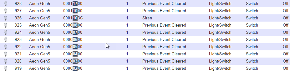

I got extra Zwave device from the first boot.
And I have seen some messages about my thermostats which where new.
2020-03-27 12:23:36.323  Status: SendSwitchIfNotExists: Device '22.instance.1.index.256.commandClasses.113' (Previous Event Cleared) with DeviceID '00001600' matches '22.instance.1.index.0.commandClasses.48' (Sensor). Domoticz will use the Dimmer (and hide the Switch).
