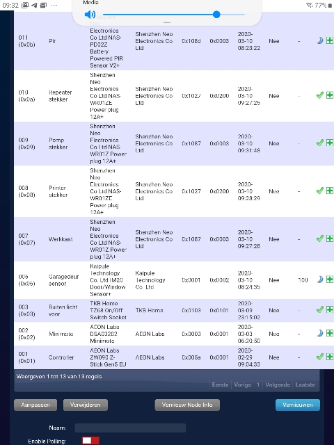

I’ve got some issues to add a kaipule im20
I know that is possible because I could read some messages about it.
Before return theses devices I need your help.
After Unser batteries I push 3 times in les than 1.5 sec and the light is blinking
But domoticz doesn’t find it....
Any clues for kapules’s owners

number 6 Did you try to include with domoticz or direct with a portable controller?

I finally found the solution.
Im20 is not unique. regarding the country, sepcifications are differents.
In europ Zwave is using 868 but in USa is 908.
I could change IM20 received and ask to send specifically europe devices and no it'works perfectly :-)
