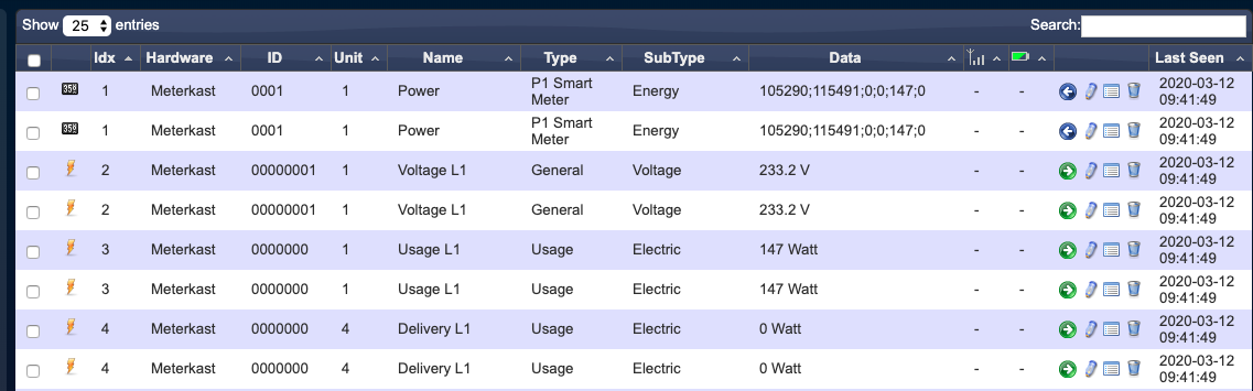

I couldn't find any related topics, so I assumed it was best to create a new one.
Last night I noticed that my p1 meter has duplicate devices in the database. I'll attach an image that shows what I mean.
When I set the Power device (IDX 1) to unused, both instances change to unused. When I add an unused device, they both get added. So, it's the same device somehow. There's only a single instance of the p1 hardware in my hardware table.
I assume this can be fixed by deleting the p1 hardware and adding it again, but I guess that means that i'll lose all the history :cry:.
Is there any way to fix this without losing the collected data up to now?
Thanks in advance!
Screenshot 2020-03-12 at 09.41.51.png (116.1 KiB) Viewed 2506 times

flemm wrote: Thursday 12 March 2020 9:50 Last night I noticed that my p1 meter has duplicate devices in the database. I'll attach an image that shows what I mean.
It is unlikely that your screen reflects what is in the database because the Idx is the primary key of the devicestatus table and must be unique (or null) by sqlite design.
If you already cleared cache and appcache (different things) it's time to look in your database (table devicestatus) with sqlite3 or similar tools.

I've found the issue, sort of. It didn't have anything to do with caching or something like that.
The devices table somehow mixes up devices and groups. I had a few groups of switches. When the table with devices loaded, the devices and groups were shown correctly. But after a few seconds, the groups change into the P1 devices. After I deleted the groups, the duplicates were gone.
So, the group IDX's conflict with the devices IDX's. Are these supposed to be 'different' indexes and therefore to be able to exist alongside each other? Or is the error in the fact that a new group gets an IDX that already exists? When I create a new group, it automatically gets IDX 1, which is already in use, and I don't see the option to change that.
After IDX 1-5 I had a gap until 22. So I fixed it by creating groups until they reached IDX 6. Not the answer to the issue, but it works.

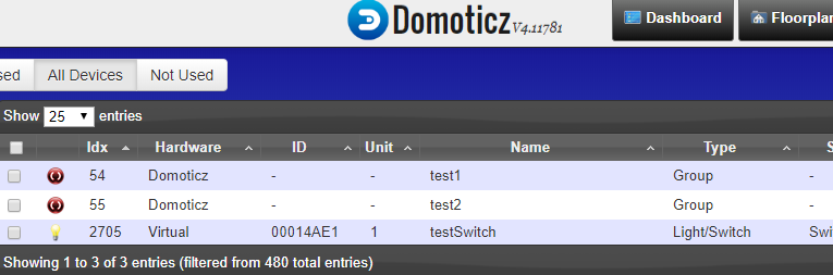

I am on the almost same version as you (V4.11781) but don't see this behavior. When I create a new group it gets the next available group-idx.
How do you create a new group ?
Groups are shown in the devices tab and can have the same IDX number but with they are shown with a different icon, 'Domoticz' as hardware and without id and without unit.
There cannot be a conflict between group IDX and device IDX as they are not mixed anywhere in the code and are in different tables in the database.
Same is true for Hardware IDX, Variable IDX , Camera IDX, etc..
If there is a conflict with these IDX's in your system there must be something seriously wrong in the database.

Thanks a lot for your explanation. I suspected groups have 'different' IDX's and can therefore have the same number as another device. I create a new group by going to 'Scenes' and clicking 'Add scene' and selecting 'Group'. I'm unaware of any other way to do that..
I've tested a little further; deleted all the groups and started fresh. A new group gets IDX 1. The problem seems to occur only with my P1 electricity meter, which has IDX 1, 2, 3 and 4. My gas meter is next (IDX 5), and doesn't show the issue. Also, the higher used device IDX's (22 and higher) work fine.
Since screenshots might not be clear enough, here's a screen recording of what happens: https://www.dropbox.com/s/iil32kvvtzxyj ... s.mov?dl=0. Hope that makes it more clear. As you can see, after a few seconds, the groups with 'conflicting' numbers, are replaced by duplicates of the P1 electricity devices. I hope you understand my confusion earlier today.. :?
Since the other IDX's than the ones from my P1 electricity work fine, I hope my database is ok.. :shock:
Thanks again for your thoughts!

flemm wrote: Thursday 12 March 2020 17:45 Since screenshots might not be clear enough, here's a screen recording of what happens: https://www.dropbox.com/s/iil32kvvtzxyj ... s.mov?dl=0. Hope that makes it more clear. As you can see, after a few seconds, the groups with 'conflicting' numbers, are replaced by duplicates of the P1 electricity devices. I hope you understand my confusion earlier today.. :?
Your recording does indeed give me another view on the issue. The 'magical' change of the groups to the device happens when the device is updated. You see that in the P1 devices because they are updated very frequent but I would not be surprised if it also happens on any other group/device combination at the moment the device is updated.
I posted this as issue 3978 on github

Thanks for your reply. I didn't realise it happened when the devices were updated. And indeed, my P1 meter is updated every 5 seconds. I've checked, and you're right! With a group with IDX 22, same number as one of my Hue bridge devices, changes to 'Hue Bridge' when the Hue is updated. So it isn't related to my P1 after all.
Mario ipsum RGB mushroom 1-up.
Re: Duplicate devices when device idx = group idx on devices tab
flemm wrote: Friday 13 March 2020 8:54 I didn't realise it happened when the devices were updated. And indeed, my P1 meter is updated every 5 seconds. I've checked, and you're right! With a group with IDX 22, same number as one of my Hue bridge devices, changes to 'Hue Bridge' when the Hue is updated. So it isn't related to my P1 after all.
Issue has been picked up and a PR is created. Fix will be in one of the next Beta's
waaren wrote: Friday 13 March 2020 22:37 Issue has been picked up and a PR is created. Fix will be in one of the next Beta's
Fixed in V4.11784

That's awesome. I've installed the update, cleared everything and it works like a charm. Thanks so much!
