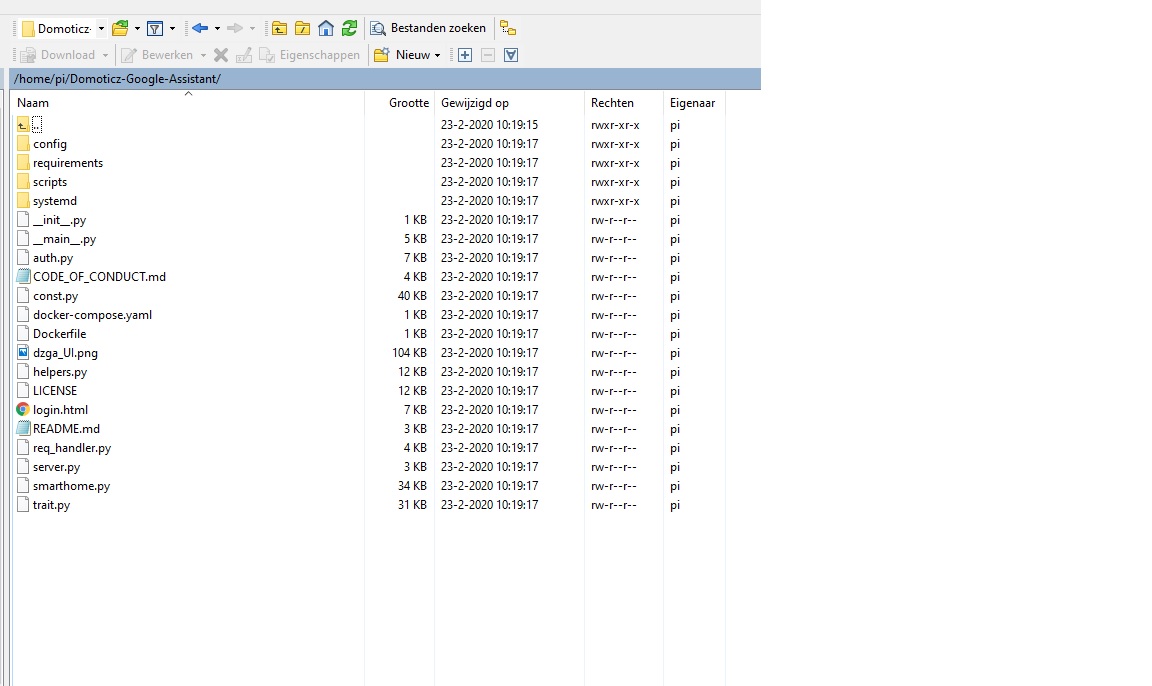

I can't get the service to run. Also i dont see config.yaml in the Domoticz-Google-Assistant folder. There is a file in the config folder. Do i need to rename and replace??
This is the error message. I saw another member had the same problem he had to remove the folder. Tried that but didnt work. I am a new user so didnt set it up.
As far as i understand i can acces the http://localhost:3030/settings without setting up the rest first??
My device runs Buster.

Justintime
Posts: 228
Joined: Thursday 21 May 2015 9:08
Re: Domoticz to Google Assistant integration
Post by Justintime »
DewGew wrote: Sunday 23 February 2020 12:24 Try start manually the you can see in terminal if there is any errors. If it works maby something is wrong in services.
cd /home/${USER}/
sudo systemctl stop dzga #If service is running
source Domoticz-Google-Assistant/env/bin/activate
python3 Domoticz-Google-Assistant
There is no file or directory. I have checked with winscp. And indeed there is none.

DewGew
Posts: 582
Domoticz version: V4.10618
Location: Sweden
Post by DewGew »
Justintime wrote: Sunday 23 February 2020 16:06 Naamloos.jpg
simpliest is to remove Domoticz-Google-assistant:
cd /home/${USER/
sudo systemctl disable dzga
sudo rm /etc/systemd/system/dzga.service
sudo rm -r Domoticz-Google-Assistant
then run the installer:
bash <(curl -s https://raw.githubusercontent.com/DewGew/dzga-installer/master/install.sh)

Thanks... Turneded out there was a checksum error on a Debian package from another source. So it only installed a part of your application.
On to the next challenges to get it to work.
