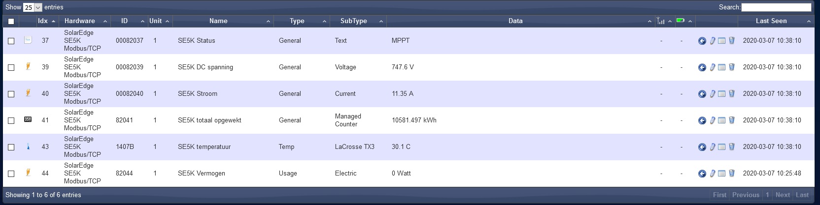

I have got one problem.
My Watts don't show up in Domoticz.
My ini file looks like:
;The idx numbers of the sensors made in Domoticz
;if idx is set to 0 (zero) it will be ignored
[domoidx]
Amps:40 ; Amps (A) Total Amps
AphA:0 ; Amps PhaseA inverter
AphB:0 ; Amps PhaseB inverter
AphC:0 ; Amps PhaseC inverter
PPVphAB:0 ; Phase Voltage AB inverter
PPVphBC:0 ; Phase Voltage BC inverter
PPVphCA:0 ; Phase Voltage CA inverter
PhVphA:0 ; Phase Voltage AN grid
PhVphB:0 ; Phase Voltage BN grid
PhVphC:0 ; Phase Voltage CN grid
Watts:44 ; Watts inverter
Hz:0 ; Hz Grid
VA:0 ; VA
VAr:0 ; VAr
PF:0 ; Percent
WH:41 ; WattHours (WH)
DCA:0 ; DC Amps
DCV:39 ; DC Voltage
TmpSnk:43 ; Heat Sink Temperature
St:37 ; Operating State
Out come of the script sunspec_ardexa -vv discover 192.168.xx.xxx 1
Amps (A) 11.35 A
Amps PhaseA (AphA) 3.79 A
Amps PhaseB (AphB) 3.76 A
Amps PhaseC (AphC) 3.78 A
Phase Voltage AB (PPVphAB) 399.1 V
Phase Voltage BC (PPVphBC) 399.5 V
Phase Voltage CA (PPVphCA) 399.0 V
Phase Voltage AN (PhVphA) 229.7 V
Phase Voltage BN (PhVphB) 231.1 V
Phase Voltage CN (PhVphC) 230.8 V
Watts (W) 2609.0 W
Hz (Hz) 50.01 Hz
VA (VA) 2619.9 VA
VAr (VAr) -239.0 var
PF (PF) -99.57 Pct
WattHours (WH) 10581497 Wh
DC Amps (DCA) 3.542 A
DC Voltage (DCV) 747.6 V
DC Watts (DCW) 2648.7 W
Heat Sink Temperature (TmpSnk) 30.08 C
Operating State (St) MPPT
Vendor Operating State (StVnd) 0
Vendor Event Bitfield 1 (EvtVnd1) 1
Vendor Event Bitfield 4 (EvtVnd4) 0
So there is production.
But in Domoticz it looks like:
Greetings,
Bart
jvdz

If you are using the last version of the script, which contains the changes I made to my version posted earlier, you don't need a seperate device for W as that is part of the WH device now, since that can/should display both when using the proper dummy device.
Maybe that should be documented as such somewhere.
check this link for the details: https://www.domoticz.com/forum/viewtopi ... 55#p238031
