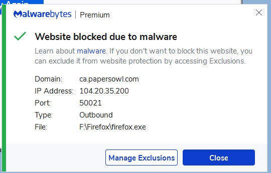

Take care, MalwareBytes flags the site as Malware
