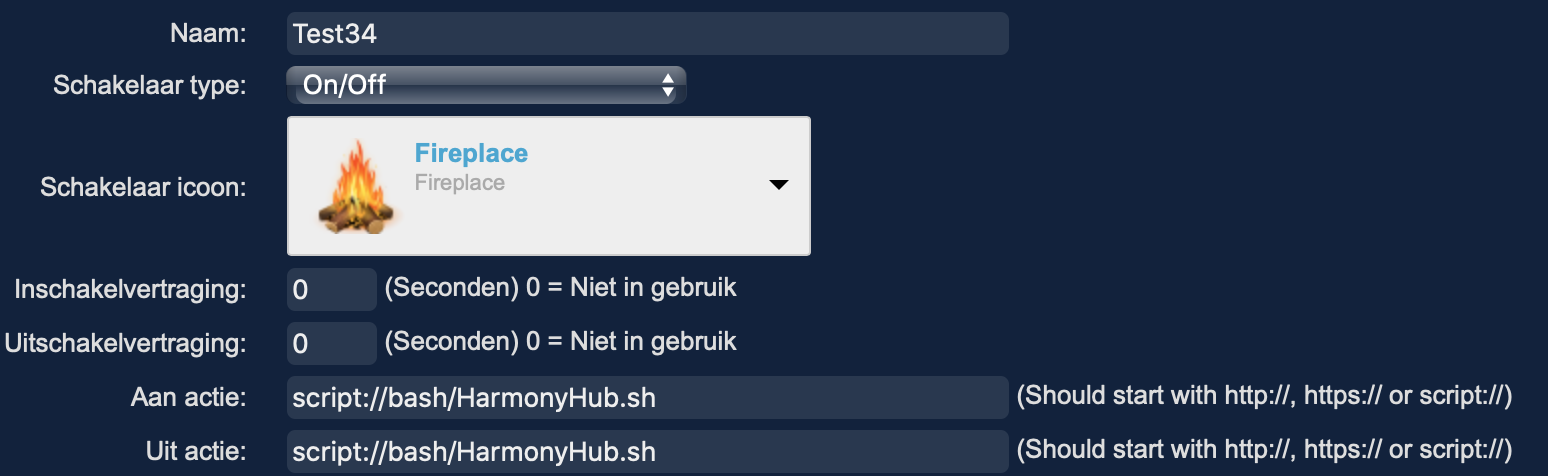

The script runs perfectly from the CLI, but when I run it as part of an ON/OFF script from a Domoticz device
Schermafbeelding 2020-03-02 om 12.18.42.png (124.15 KiB) Viewed 1744 times
I get a 256 error
Error: Error executing script command (/home/pi/domoticz/scripts/bash/HarmonyHub.sh). returned: 256

Can you try it with the full path?
script://home/pi/domoticz/scripts/bash/HarmonyHub.sh
Do a chmod 777 on the script to bypass a rights issue as well.
