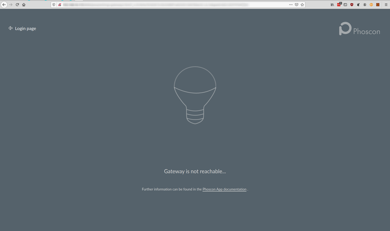

Since today I cannot access the gateway through the Phoscon app. It says:
I have reset the device and unplugged it to see if I could connect again but unfortunately not.
Deconz and deconz-gui are working fine as are the devices and scenes. It is just accessing the gateway that doesn't work.

Ok so I understand better, Phoscon is working but if you try to go on "gateway" menu you have this screen ?
And you are sure deconz is working ATM ?
If it have worked before the firmware update, I thnik it will be better to rollback the firmware. Are you too using the last deconz version ?

I have tried https://phoscon.de/pwa/etcetera_etcetera_etcetera but then I get "login failed".
If I use http://192.168.16.115:8080/pwa/index.html/etcetera I can login and see the devices and scenes but cannot access the gateway. If I try to access the gateway using the local url (on my pi 127.0.0.1:8080) I get the same results.
Deconz(-gui) is running just fine and all devices are reachable. Only I cannot access the gateway.
deCONZ_ConBeeII_0x26530700.bin.GCF is not marked as Beta. Are you sure I'd better wait? Now that I write that down... I can only update a final firmware from the Phoscon app if I can access the gateway ;)

So to resume
- Deconz is working
- Phoscon is working
- All your devices are working
But the link "gateway" in the menu give you this error ?

Correct! Deconz, Phoscon and devices working. Only access to gateway through Phoscon app does not work.
It the firmware is Beta I will skip it and wait for RTM or final.

The issue is solved by changing from beta repository to the stable repository. I got a brilliant tip from cs42 at the GitHub discussion board. Have a look here: https://github.com/dresden-elektronik/d ... ssues/2517
