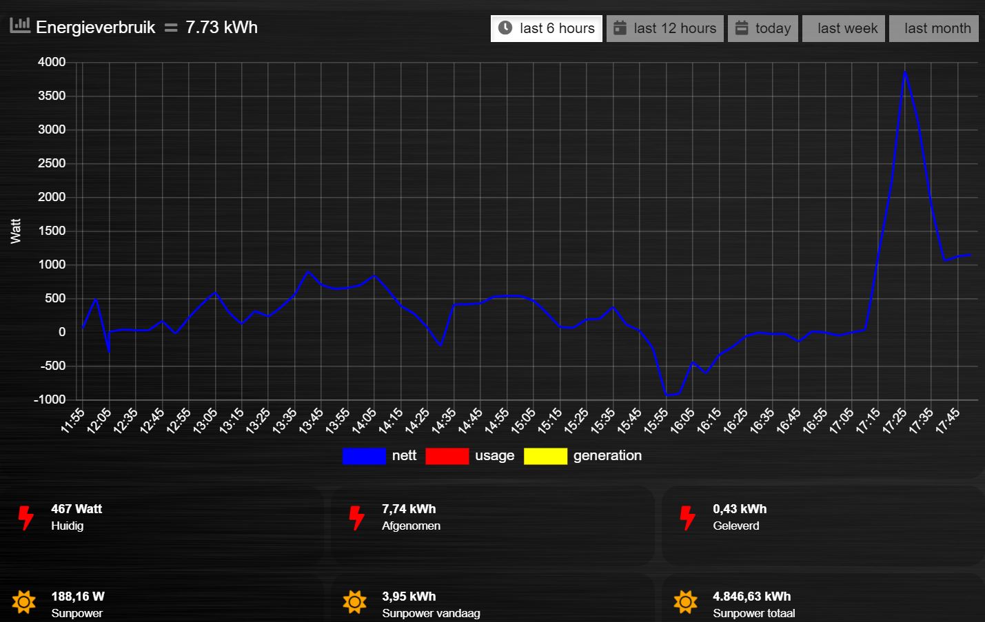

This afternoon i did a sudo apt-get update and the system installed php 7.4. Now my dashticz graphs only show the generation line and not the bars anymore. Only the last week and last month views still work. Does anybody know what happened?

The graph module doesn't use PHP, so I don't think it's caused by the PHP 7.4 update. Maybe @clinkadink can help.
clinkadink
Posts: 417
Location: Swindon, UK
Re: Dashticz - v3.4.0 Beta
Post by clinkadink »
I have just tried your graph block, but with my devices, and it works fine. The single line and two bars show for all range buttons.
If it was working correctly before the apt-get update, I don't think its a graph issue.
