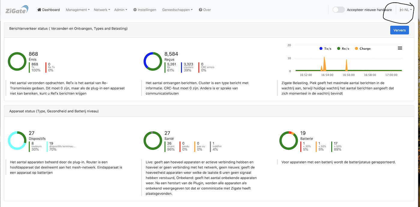

If you are on the Web Admin Page, you can select the language on the upper left corner
Screenshot 2020-02-26 at 17.02.04.png (321.2 KiB) Viewed 513 times
