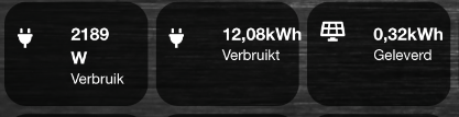

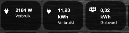

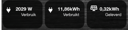

I moved from Dashticz version 2 to version 3, but I struggling to get the text correct in the blocks on my Ipad.
On my Ipad version 2 look like:
Text place well within the blocks.
In Dashticz version 3 first I had to make the icons smaller by:
far,.fas,.wi {
  font-size:15px;
But the text keeps to the right.
I tried to shift the text more to the left by:
.title {
    margin-left: -15px !important;
But the text on row 2 and 3 keeps to the right where it will have issues on other blocks
Any idea how I can move all rows further to the left and having more characters on one line?
Attached css file:
CUSTOM CSS FILE
