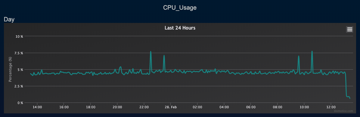

I have a question about the dzvents script, as well. After some struggle I got your script to work, and it's awesome! Finally able to control my Nest properly through domoticz. Thanks a lot.
One question though, since I added the dzevents setpoint script, my CPU usage increased quite a bit. From <1% to about 5%, with bumps to 7%. I know it's still not much, but it surprises me that such a simple script could increase it so much. And i'm quite a freak when it comes to running things as smooth as possible.. When I disable the script, it immediately drops back to the previous values. I'll post a graph as well.
Is there something i can do to make it less heavy on the CPU? Maybe limit the numbers of checks or something? Or is this a dzevents-related side effect? I have absolutely no experience in scripting or knowledge about how this plugin works, so maybe i'm just asking stupid questions..
- Screenshot 2020-02-28 at 13.26.36.png (217.51 KiB) Viewed 3229 times
Mario ipsum RGB mushroom 1-up.

strange, I don't have that behaviour, I also shouldn't be, because it's only fired on a device change, did you created it from the domoticz event gui, create a new event->dzvents->device ?flemm wrote: Friday 28 February 2020 13:28 I have a question about the dzvents script, as well. After some struggle I got your script to work, and it's awesome! Finally able to control my Nest properly through domoticz. Thanks a lot.
