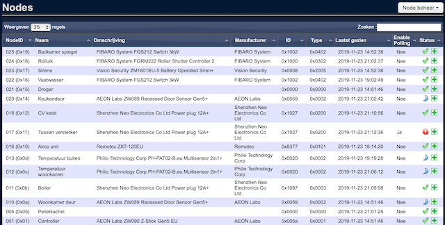

I tried your latest script, but I get not a "Jamming gedetecteerd"
I tried to simulate with a device "Tussen versterker" I removed this device but no succes "Jamming gedetecteerd"

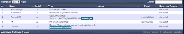

I don't know exact what IDX for the USB Wave stick can use. Is it 4 or 1 ? See below pictures.
Re: Jamming error
Knibor wrote: Saturday 23 November 2019 21:32 I tried your latest script, but I get not a "Jamming gedetecteerd"
Can you please share what's in the log ?
It is 4
