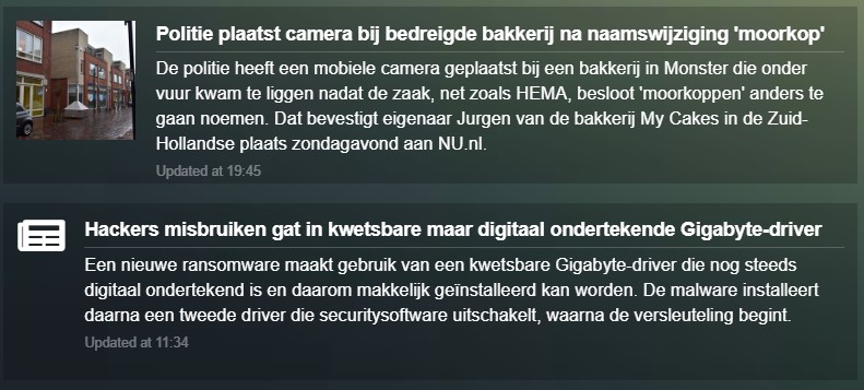

* The News block will show the inline images. By setting the news block parameter 'showimages: false' the inline images will be hidden.

News
Newsblock with inline images:

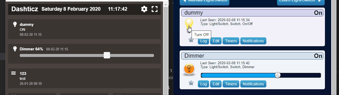

Websocket
The Websocket connection is only supported by the Domoticz development branch. If you update your Domoticz version make a backup first! The Domoticz development branch might give issues on your system, and you cannot downgrade your Domoticz database.
Websocket connection in action:
