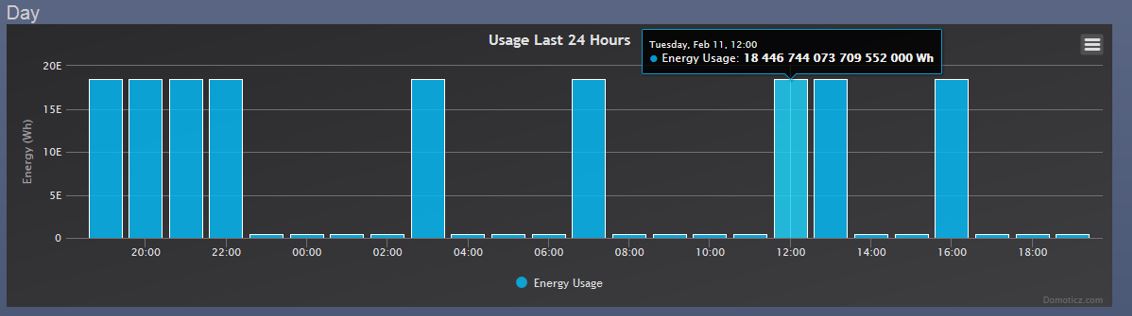

The Timeout function is working :lol: , only sometimes i get some strange values and the increment counter of my boilermeter is not counting right and how do i show the local variable in the domoticz logfile?

Changed some logic in below script. Best to start with new virtual devices and another script name to prevent mixup with old data.
Also shows how to get information to the log.
