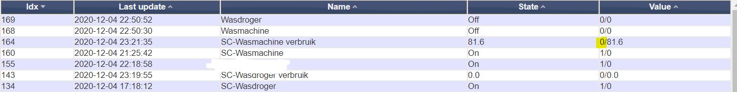

First of all, thanks for this script!
I've installed the latest script as an dzVents lua script by copy-pasting it in domoticz and every 5 minutes it runs nicely, but when I check the log it says:
2020-12-05 10:25:01.138 Status: dzVents: Info: POW: ------ Start internal script: Was_Droog:, trigger: "every 5 minutes"
2020-12-05 10:25:01.138 Status: dzVents: Info: POW: Monitoring 0 apparaten.
2020-12-05 10:25:01.139 Status: dzVents: Info: POW: ------ Finished Was_Droog
I've made the following switches:
The SC-Wasmachine and SC-Wasdroger are the protected switches and physical sockets pluged in to an outlet
The SC-Wasmachine verbruik and SC-Wasdroger verbruik have the types "electrical" and are the ones having the output in Watts and I saw that they have the value of 0/xx, perhaps that's why the script is not working?
The Wasmachine and Wadroger are dummy-switches which have to be turned on and send a notification when the wasmachine or wasdroger are ready.
Can someone help me monitoring more then one apparaat (device)?

Your output of the devices you use looks peculiar. Output doesn't seem to be in Watt? Can you post the info from Setup / Devices?
mine looks:
1154	Ribes	0009301	2	SC-Wasmachine gebruik	Usage	Electric	0 Watt	-	-	   	2020-12-05 16:40:05
xxfile
Joined: Saturday 05 December 2020 10:20
Re: Is the washing machine done?
Post by xxfile »
Hi felix63,
Thanks for replying. My screenshot is made where you can add scripts: (More options / Events)
The info from Setup / Devices is:
164	ZWave USB	0011401	2	SC-Wasmachine verbruik	Usage	Electric	17.8 Watt	-	-	   	2020-12-06 10:05:39
Today is the perfect day to test the script, because it is laundry day :lol:
Edit:
I think I see the problem. My devices are called "verbruik", in your output it says "gebruik". Oops! :oops:
It works!
