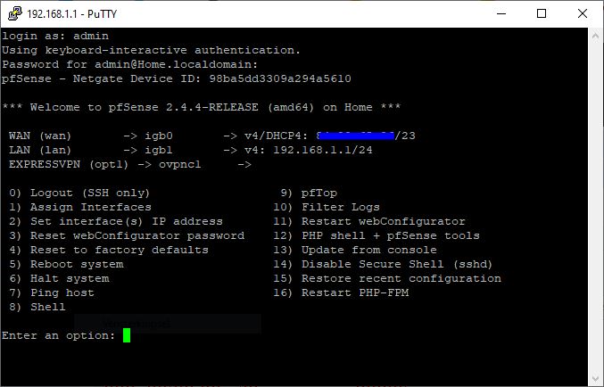

My router is a pfSense based system.
When I login with SSH on this router, a menu is openened.
Selecting no. 8 is the Shell
Is there a work-around trick to get into the shell?

gschmidt
Posts: 200
Joined: Thursday 20 December 2018 11:03
Re: Python plugin: Presence detection from wireless router
Post by gschmidt »
OK...I had to create an additional user with admin rights on pfSense.
Then you can ssh straight into the shell
But the Domoticz log shows the following error:

2020-02-12 21:07:53.757 qcsapi_sockrpc: not found
2020-02-12 21:07:53.757 ip: not found
2020-02-12 21:07:53.757 brctl: not found
The router has no WLAN interface, I use 2 AP's instead
The only command that works is (just like the windows cmd command)
arp -a
This returns a list of devices in this format:
(192.168.1.72) at d4:63:c6:78:1d:2d on igb1 expires in 873 seconds [ethernet]
igb1 is the LAN interface of the mini-pc
I don't know exactly what iDetect is looking for, but can I create a custom tracker with syntax options?
The plugins auto detection will indeed fail on ssh hosts without the usual Linux commands.
You could configure the tracker as
192.168.1.1#ssh=arp -a
If you are satisfied with the results you can turn it into a custom tracker with that syntax
gschmidt
Posts: 200
Post by gschmidt »
returns:
2020-02-12 22:34:31.560 Error: (iDetect) 192.168.1.1 ====> SSH returned error:usage: arp [-n] [-i interface] hostname
2020-02-12 22:34:31.560 arp [-n] [-i interface] -a
2020-02-12 22:34:31.560 arp -d hostname [pub]
2020-02-12 22:34:31.560 arp -d [-i interface] -a
2020-02-12 22:34:31.560 arp -s hostname ether_addr [temp] [reject | blackhole] [pub [only]]
2020-02-12 22:34:31.560 arp -S hostname ether_addr [temp] [reject | blackhole] [pub [only]]
2020-02-12 22:34:31.560 arp -f filename
2020-02-12 22:34:31.560 Error: (iDetect) 192.168.1.1 ====> SSH returned empty response. Transport active: True
gschmidt
Posts: 200
Post by gschmidt »
Working!...I forgot that the pfsense user cannot be admin, but it should be the new user I created with admin rights
