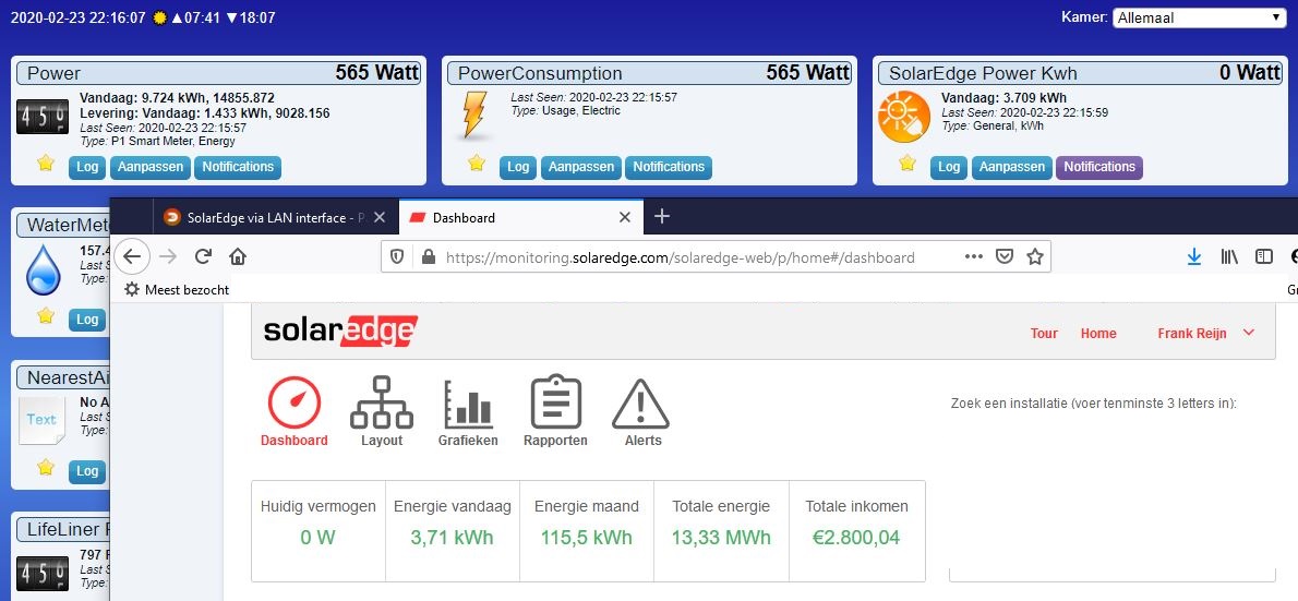

Posts: 536
Domoticz version: Stable
Re: SolarEdge via LAN interface
Post by freijn »
I do not have computed but from device :
Perfect match.. although SolarEdge does a round up...

Posts: 28
Joined: Thursday 26 July 2018 12:07
Post by rogerthn »
OK, I'll change AC Power to From device and see, fingers crossed :D
