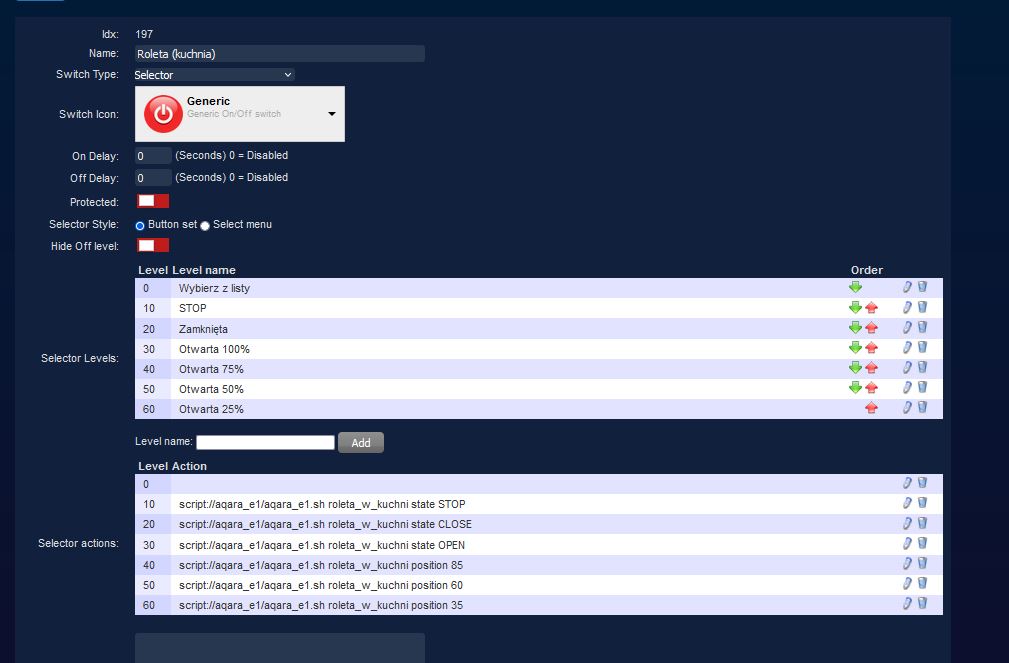

pawol
Joined: Saturday 25 September 2021 21:32
Location: Poland
Re: Curtain Switch Zigbee2mqtt adapter
Post by pawol »
I did it by means of selector + bash script
aqara_e1.sh.txt
(1.17 KiB) Downloaded 35 times
