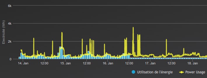

Each time the MySensor power meter resets the power usage value (such as after a power cut, reboot or domoticz update), this causes a couple of glitches :
- the detailed hourly power usage histogram of the log goes flat after the reset time (even though the values in the Meter table are not null after the reset time, they are just shifted down):

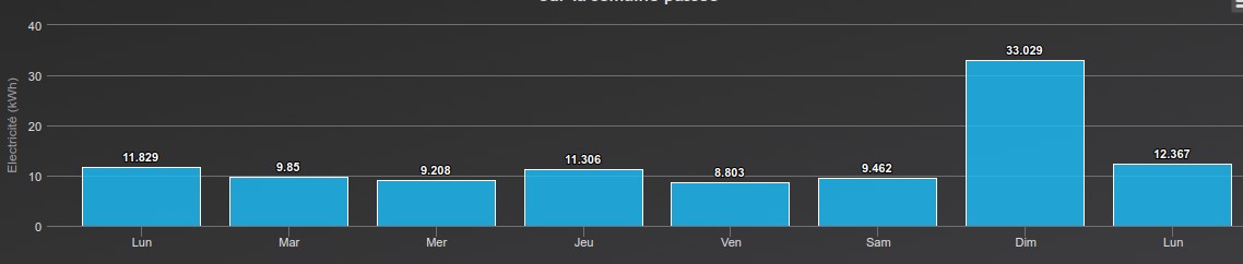

- the daily power usage over the last week histogram shows a spurious value on the day the reset took place (the histogram bar take the value of the last power usage measure before the reset):
which corresponds to the reset seen here in the database meter table:

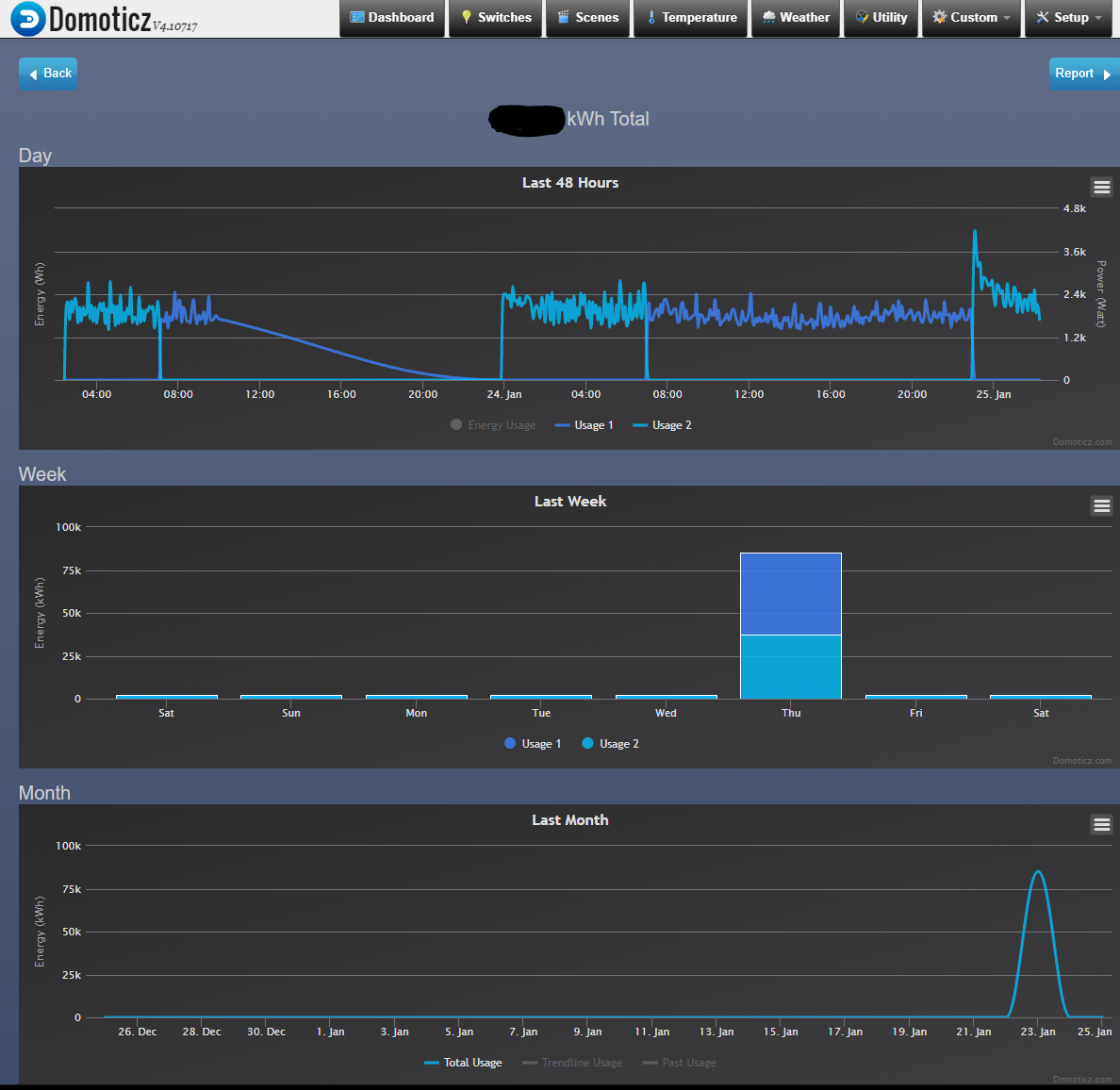

I believe I'm having the same kind of problem.
I'm living in France, where National Electricity Company is replacing all Electricity Meter for everybody.
When it's done, the tech which does this has to inject old indexes into new meter.
I'm assuming this because of the value which has been added (85 MegaWatts).
I restored a backup thinking that if I can skip the first seconds of new meter, it would be ok, but no.
image attached
Is there a way to correct ? Or should I delete device, and create a new one, to handle the new meter ? If so, can I keep historical datas of old meter ?
