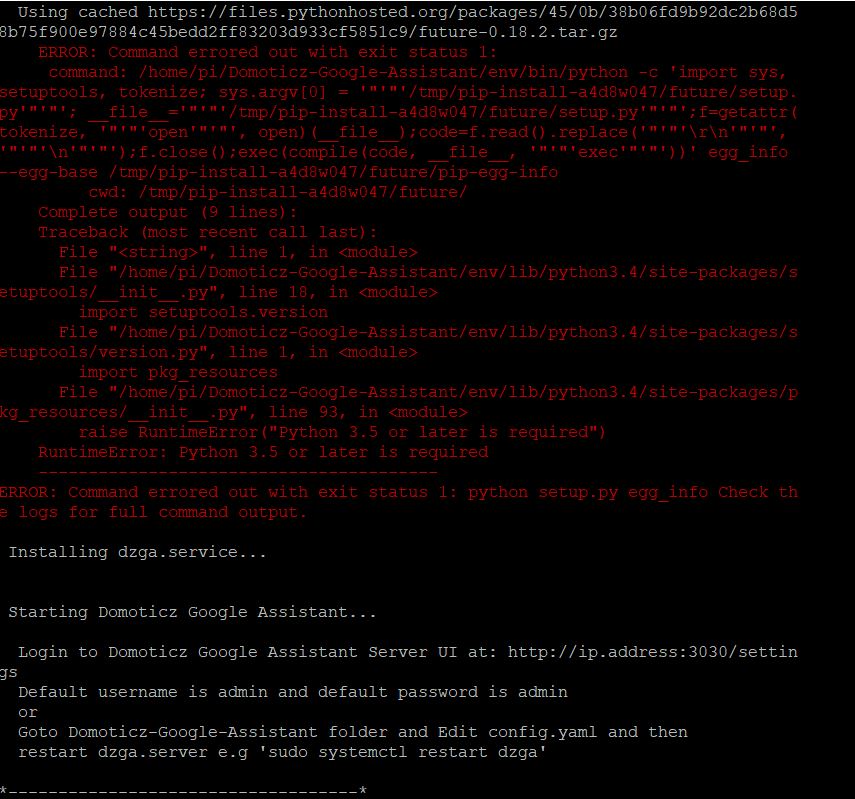

Recently I bought a Google Home mini which I want to use with my Domoticz system, the only problem is i'm struggling with the setup of the Google Assistant.
And it seems after a couple of evenings of trying i'm in a loop :(
I read several articles, but unfortunatly without any luck, perhaps one of you can help me out.
I'm using a RPI and this is what I've done thusfar.
I've upgrade the Python version as described in following link: (Which took a while!)
https://installvirtual.com/install-pyth ... pberry-pi/
After installation of python-3-7 I checked if it was installed with command.
python --version
It showed the version as mentioned her above.
Next I followed the steps as described in the link here below for installing Google Assistant.
https://www.domoticz.com/wiki/Google_As ... ver_python
But after the installation was complete I saw that the output showed some red lines stating that Python 3-5 or later was required!?
Opening the link as mentioned at the end of the script lead off-course that the Page couldn't be displayed.
Help is highly appreciated.
Kind Regards,
Arie
Google Assistant error message.JPG (120.49 KiB) Viewed 4230 times

It looks you have python 3.4 installed in your virtual environment.
Find out what versions of python you have installed. Uninstall version 3.4
Do an ls -al /usr/bin/pyth*
I used controlicz, it works, but costs a monthly fee. Domoticz Google Assistant is free and works perfect.
I think it too.
If you followed the procedure, as described in your link, you use "sudo make altinstall"
This creates a version 3.7.*, besides your 3.4. You have to uninstall this version 3.4
