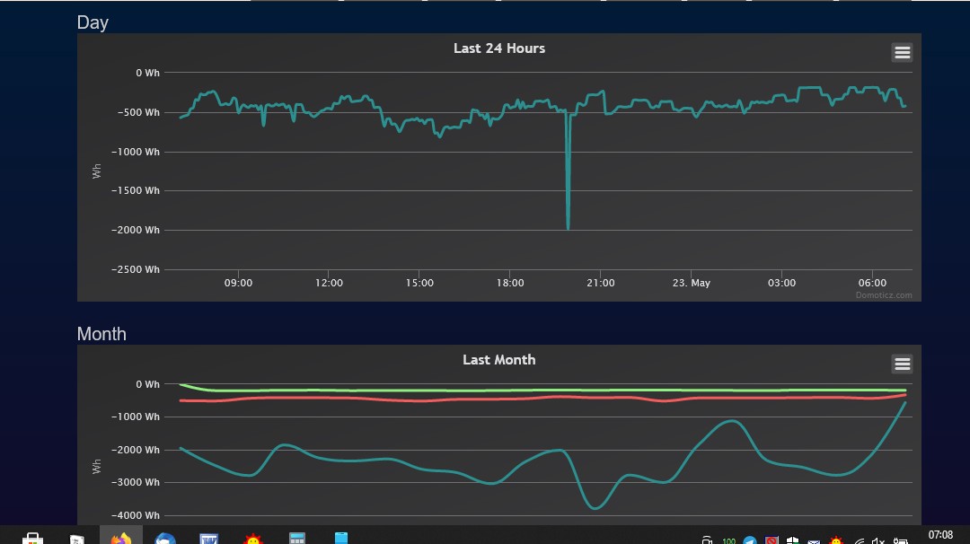

Re: Months kWh usage to virtual counter
Post by kniazio »
I have such an error
Error: dzVents: local netWork not open for dzVents openURL call !

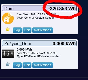

Now I have
Start internal script: FCounter: HTTPResponse: "oneMonthTotal_year"
2021-05-23 06:53:00.623 Status: dzVents: Debug: oneMonthTotal: Processing device-adapter for Dom: Custom sensor device adapter
2021-05-23 06:53:00.625 Status: dzVents: Debug: oneMonthTotal: Processing device-adapter for Zużycie_Dom: Counter device adapter
2021-05-23 06:53:00.625 Status: dzVents: Error (2.4.15): oneMonthTotal: An error occured when calling event handler FCounter
2021-05-23 06:53:00.625 Status: dzVents: Error (2.4.15): oneMonthTotal: .../domoticz/scripts/dzVents/generated_scripts/FCounter.lua:39: bad argument #1 to 'ipairs' (table expected, got nil)
2021-05-23 06:53:00.625 Status: dzVents: Info: oneMonthTotal: ------ Finished FCounter
Perhaps because the value that the script calculates for me is with a "minus" sign

I ran the script on a brand new system on another Raspberry Pi4
kniazio
Posts: 202
Joined: Thursday 06 October 2016 8:14
Domoticz version: 3.7243
Post by kniazio »
I chose another meter for counting monthly energy which shows positive values and the script worked immediately. Probably the problem lies in the negative results of the measurement
kniazio
Posts: 202
Post by kniazio »
Can it be solved somehow?
