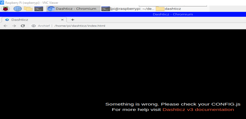

I am new to Dashticz so forgive me if I am asking something stupid.
The installation of Dashticz succeeded but I am not able to connect to Domoticz.
Everytime I get the message there is something wrong with the CONFIG.js.
I have added three pictures to show my status of the installation.
Who can tell me what I am doing wrong....

Lokonli
Posts: 2296
Re: Dashticz V3 - Automatic installation
Post by Lokonli »
Can you post your CONFIG.js from the custom folder?
It probably contains an error.
