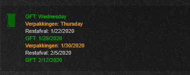

i switched to the master version but the garbage module is still not working. It only shows a black garbage container.
This is the code in the config.js:

yes i filled in my zipcode and housenumber in the config.js and you are more then welcome at my home so i can show you my system, but to invite everybody ;-).
in the console tab i see the following error:
VM1415:417 Uncaught TypeError: Cannot read property 'charAt' of undefined
at getTrashRow (<anonymous>:417:68)
at <anonymous>:446:49
at Array.forEach (<anonymous>)
at addToContainer (<anonymous>:445:17)
at Object.success (<anonymous>:159:13)
at fire (bundle.js:48)
at Object.fireWith [as resolveWith] (bundle.js:48)
at done (bundle.js:48)
at XMLHttpRequest.<anonymous> (bundle.js:48)
see row number 2 and 5.....could that be the error?
My responde code is:
{"userMessage":{"type":null,"messageCode":0,"description":null},"ExtraOption":
At calander the responde code is:
{"userMessage":{"type":null,"messageCode":0,"description":null},"ExtraOption":{"$type":"System.Dynamic.ExpandoObject, System.Core"},"dataList":[{"pickupDates":["2019-12-20T00:00:00","2020-01-03T00:00:00"],"pickupType":18,"_pickupType":18,"_pickupTypeText":"GREENGREY","description":"Route Duo 3 Rest"},{"pickupDates":["2019-12-13T00:00:00","2019-12-27T00:00:00","2020-01-10T00:00:00"],"pickupType":10,"_pickupType":10,"_pickupTypeText":"PACKAGES","description":"Route Duo 3 Kunststof"},{"pickupDates":["2019-12-24T00:00:00","2020-01-07T00:00:00"],"pickupType":2,"_pickupType":2,"_pickupTypeText":"PAPER","description":"Papier 06 Wijk 10,12,54 & 55"}],"intDataList":null,"data":null,"status":true,"messageCode":107,"pdfResponse":null,"token":null,"ID":null,"invalidParameters":null,"total":0,"messageToString":null}

madradrakie wrote: Thursday 12 December 2019 22:06 yes i filled in my zipcode and housenumber in the config.js and you are more then welcome at my home so i can show you my system, but to invite everybody ;-).
The calendar responses look ok.
The error is not ok.
I can reproduce the error. Temporary workaround: Add the following to your config.js:
config['garbage_use_names'] = 1;
Later this week I'll try to make a real fix.

I have add the workaround and now it shows:
Zwart: Vandaag
Zwart: vrijdag
Zwart: 24-12-2019
Let me know if i can test anything for you.

Almere changed it's garbage interface again...
It's fixed in the latest beta.

It's my first time using the garbage collector. It works fine, but not jet good enough. I also used twentemilieu for the garbage_company.
Lines are showing, but no blue paper line, wich should be picked up 22-01-2020.
config['garbage_company'] = 'twentemilieu';			//https://dashticz.readthedocs.io/en/beta/blocks/specials/garbage.html
config['garbage_icalurl'] = '';
config['garbage_calendar_id'] = '';
config['garbage_zipcode'] = 'the-correct-zipcode';
config['garbage_street'] = 'the-correct-address';
config['garbage_housenumber'] = 'the-correct-number';
config['garbage_housenumberadd'] = '';
config['garbage_maxitems'] = '12';
config['garbage_icon_use_colors'] = 1;
config['garbage_use_colors'] = true;
config['garbage_use_names'] = 0;
config['garbage_use_cors_prefix'] = 1;
config['garbage'] = {
        gft: {kliko: 'green', code: '#00bf00', name: 'GFT', icon: 'img/garbage/kliko_green.png'},
        pmd: {kliko: 'orange', code: '#ffa500', name: 'PMD', icon: 'img/garbage/kliko_orange.png'},
        rest: {kliko: 'grey', code: '#bfbfbf', name: 'Restafval', icon: 'img/garbage/kliko_grey.png'},
        papier: {kliko: 'blue', code: '#0742e5', name: 'Papier', icon: 'img/garbage/kliko_blue.png'},

Twente Milieu has been fixed in latest beta.
(I did not change the release number yet: just pull the latest version from Github)
