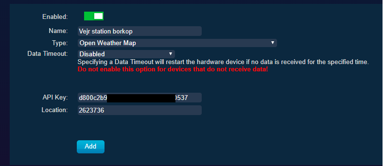

Hi i have the same issue.
see my settings on the attached picture.
what do i do wrong?
the API key is from my setup page on OWM
the location key is copied from the browser adresse for the local town's weather station.
(https://openweathermap.org/city/2623736)
openweather setup.png (20.89 KiB) Viewed 10087 times

i have solved the issue, by trial and error.
the setup look like this now

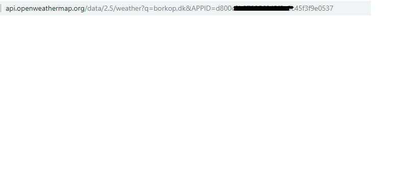

to test if the city, and or your api Key is correct you can test it in your browser like this:
test adres.png (5.17 KiB) Viewed 10087 times
then you get this result back if all i okay:
test res.png (12.85 KiB) Viewed 10087 times

mhko wrote: Thursday 21 March 2019 11:02 i have solved the issue, by trial and error.
My setup looks exactly the same, but there are still no devices created.
mhko wrote: Thursday 21 March 2019 11:02 to test if the city, and or your api Key is correct you can test it in your browser like this:
I tried this and get the correct data for my location in my browser.

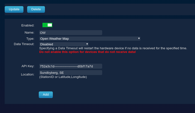

It doesn't work with the location ID (found in OWM's city list)
It doesn't work with the geographical Lat/Long.
It does work with city,country as mentioned previously.

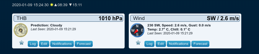

Thanks, works great now with city, country!
Screenshot 2020-01-09 at 15.24.21.png (42.75 KiB) Viewed 7471 times
Screenshot 2020-01-09 at 15.24.35.png (39.87 KiB) Viewed 7471 times

Now I also got Open Weather Map installed and allowed new device for 5 min, and got the new devices. thank you all for your posts and pictures

For future reference, this might be easier then trying to read it from a screenshot:
To test your location and API key:
http://api.openweathermap.org/data/2.5/weather?q=amsterdam,nl&APPID=[YOURAPKEYHERE]
