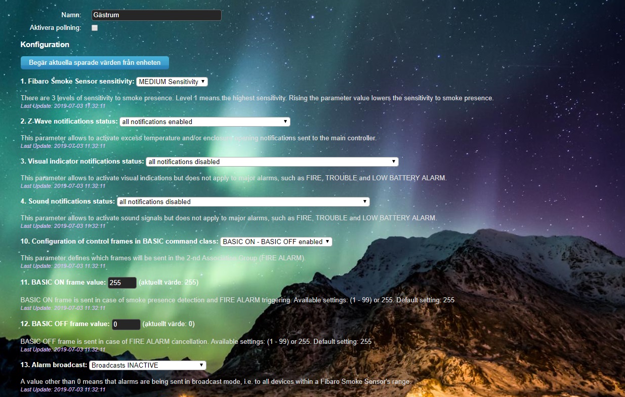

I have 3 equal Fibaro Smoke sensors mounted in the ceiling, for approximately one month ago, two of them stopped reporting temperature.
Not at the same time, maybe a week apart from each other.
Well, I thought maybe they were out of batteries or something, replaced batteries and no difference.
I sat down yesterday and tried to give it a little more effort to get them to send temperature updates.

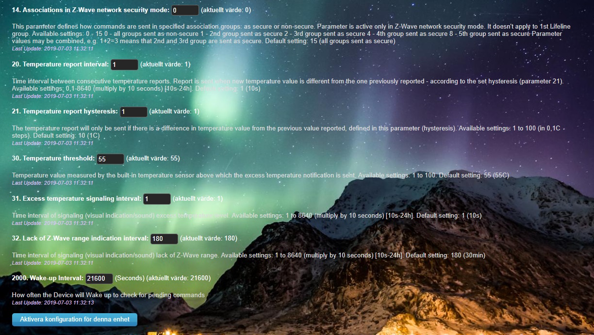

I think I have tried everything, resetting the smokes sensors, exluding, including again, and I can get them to update temperature on new devices of course since I have reincluded both, but temperature updates only comes manually.
When I press the fibaro sensor B button 3 times.
If I check "parameter" list in domoticz hardware page, I have the exact same settings on all three devices, bust just one of them are working.
Here are parameter list.
Someone who has a bright idea? :)

Edit: Theese are not new sensors, they have all worked for a couple of years flawlessly.
I am thinking that maybe some update for domoticz may have caused this?

Doing that the log seem to show that the configuration has been downloaded to the device correctly, and the temperature is read at the point of configuration, but temperature reporting still does not work as expected tellpopeyes.
