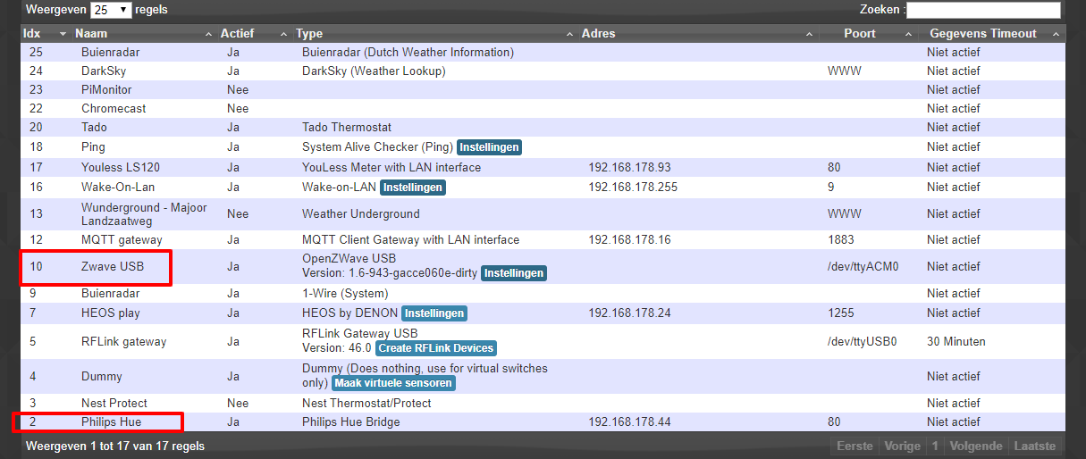

Post by bramski »
I'm pretty sure you can manage HUE lights with all zigbee sticks, but not sure if you can still use the Philips HUE app and scenes etc.
Why do you want to replace your hue bridge? You can connect it to domoticz without any hassle. Also the power usage is very low of the bridge. This way you can operate the lights with the domoticz interface/scripting and you can still use the native HUE app and other anroid/IOS apps which are dependend on the bridge.
For your other home automation needs you choose one standard (i.e zwave or zigbee) and buy a stick to manage those.
Edit
I read you already bought the z-stick.
Than you have the same setup as me.
In the hardware tab in domoticz you need to setup both your hue bridge and zwave stick. See screenshot.
Than in the "devices" tab all devices will be visible and you can use them.
