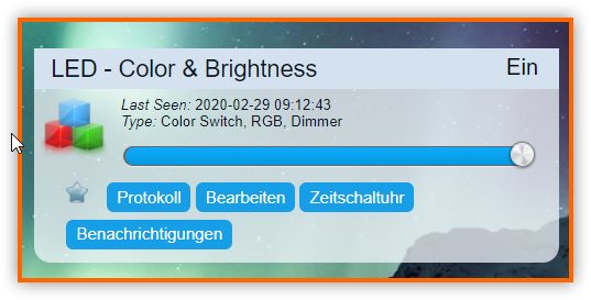

Hi. I have been told that the switch remains on even though the lamp has been switched off.
Can you fix that?
2020-02-29 09:12:43.088 Status: User: Admin initiated a switch command (6473/LED - Color & Brightness/Off)
Can you fix that?
- sshot-2.jpg (31.95 KiB) Viewed 4804 times

salopette
- Posts: 187
- Joined: Tuesday 07 March 2017 21:03
- Domoticz version: BETA
- Location: Germany
Re: Python Plugin: WLED
Hi, is there a solution to the problem I have described?salopette wrote: Saturday 29 February 2020 9:13 Hi. I have been told that the switch remains on even though the lamp has been switched off.
Can you fix that?
