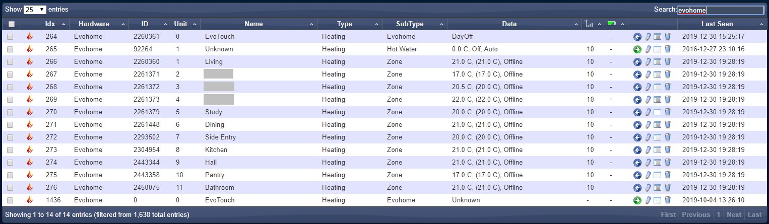

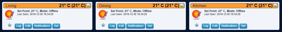

The state of Evohome devices goes to the state as shown in the picture...
Also the Temperature devices show offline and a broken icon...
This has been a long standing problem for me where I can't rely on the state of these devices (TemporaryOverride, PermanentOverride, Auto, etc.).
I wish someone has seen this before and maybe has a solution!?
I did try the latest Beta which might offer a solution as I don't recall having seen it. However, the Beta has other issues that made me go back to a new install of the latest stable release.
Rene.
