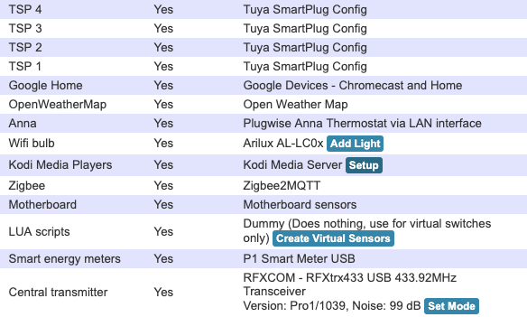

I had the plugin working like a charm for several weeks / months.
With updating Domoticz to the latest release it seems there is a problem introduced.
The plugin does not connect anymore to any of the devices.
running latest version of Domoticz (11020), updates pychromecast and gtss with pip3 upgrade and running latest version of the plugin.
Hardware = RPI3B+ running Stretch on a USB SSD.
Following plugins installed:
Screenshot 2019-07-18 at 14.42.46.png (69.68 KiB) Viewed 5100 times
Screenshot Google plugin:
Screenshot 2019-07-18 at 14.34.21.png (181.88 KiB) Viewed 5101 times
This is my logfile (Python debugging enabled):
Logfile.txt
(18.58 KiB) Downloaded 181 times
Tried soft and hard reboots, no luck so far.
Also getting sometimes the following error:" Error: CConnection_disconnect, disconnection request from 'Google Home' ignored. Transport does not exist."
Any ideas ??
UPDATE !!!!
Disabled WLAN on the RPI and errors are gone.
Enabled WLAN again, problems occur again.
Seems the IP transport layer has some effect on it.
Will keep WLAN disabled, as I do not need it anyway.
