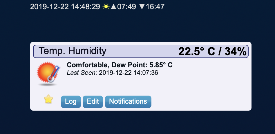

I want to replace the humidistat control on my Furness with a z-wave controlled switch by reading the humidity from my z-wave thermostat and turning a switch "on" if the humidity drops below 45%.
My thermostat is a Honeywell Honeywell Lyric T6 Pro Zwave Plus Thermostat. I get to see the Humidity under the Temperature tab.
The issue I have is how to Index and read the value of the Humidity in a DZvents script?
Also, I'd like to add some logic that the script will detect the mode to be "Heat" and the Fan is on "Auto".

AlleyCat wrote: Sunday 22 December 2019 20:53 The issue I have is how to Index and read the value of the Humidity in a DZvents script?
Script below is only the basic part. For the other stuff you will have to explain what device types / sub types the thermostat and fan are in the domoticz devices tab.
