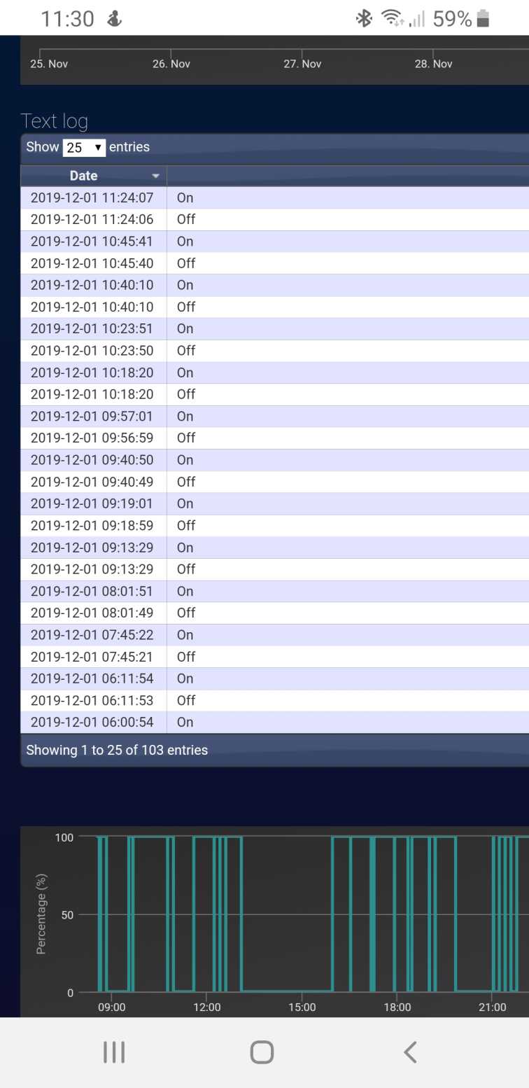

I have the plugin working on my orbi setup.
There are a lot of device changes, both on ios and android at exact the same times.
Screenshot_20191201-113054_Samsung Internet.jpg (77.6 KiB) Viewed 4169 times
Did you have a look at the logs? Are there any errors around the time of the changes? If not my first guess would be that your poll times and grace period(s) are about the same. A tag will show offline if presence was not confirmed within its grace period, so if both are set to eg 60 seconds the confirmation might be a few (milli)seconds late because polling takes time too. There are some other timing things at play (within a 5 second range) that can make it seem to work most of the time, but just miss its deadline occasionally. So general rule of thumb: make sure there are serval polls within the grace period.
In my (ssh) setup the grace period is A few seconds more than four times the poll interval. This way even an occasional poll failure or WiFi disconnect will not cause a false negative. I don’t have a lot of experience with the orbi but am still running a test over a vpn connection to my parents house (they have an orbi) with a grace period of 120 seconds and poll interval of 50 seconds. So there are always two polls within the grace period. It has been rock solid for two days, even over a vpn. The same ratio with shorter times should be no problem on a local network.
drwurn
Posts: 68
Joined: Sunday 10 June 2018 16:59
Re: Python plugin: Presence detection from wireless router
Post by drwurn »
Didn't have any errors.
Changed the grace to 45 and poll is 15. Now gonna look how this is holding up.

You say you got it to work, so it means it detects your device's presence?
I get errors now and then, I suppose my router (Netgear Orbi) sometimes is not replying (busy) or someone else is using the account (my router only allows 1 login a a time). Could these be the case for your router also? For me these errors are not causing the plugin to malfunction, in your case?
