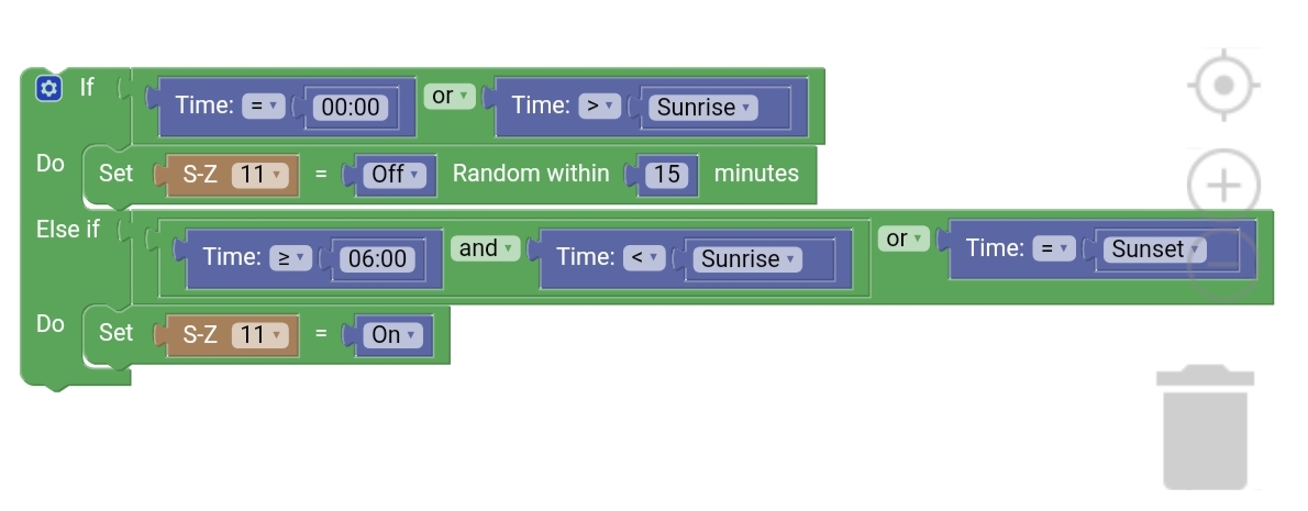

What I want to accomplish is:
The light goes on at sunset, light goes out at 00:00
And the light goes on at 06:00 until sunrise. So these days the light stays out because sunrise is at 05:xx
Can't make it work.

To me, the blockly in the first post looks valid. “Can’t make it work” is too little info. Which part isn’t working? What does the log say at those specific moments that something should happen? For example: the log should say that the script has run at 00:00. Between 00:00 and 00:15 it should mention that 11 is turned off.
