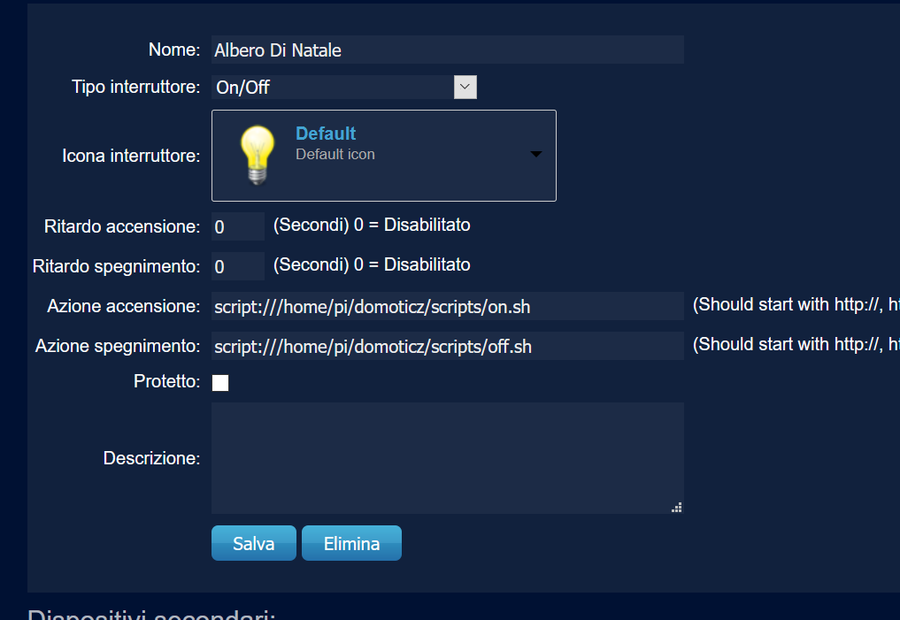

Hello I need help not knowing how to set up a script for domoticz for my twinkly led lights I found this that is compatible for home assistant and I managed to do it by directly connecting the execution on and off (see photo) I was looking for help on how to update the status of the device when I run this command!
Command of script
https://github.com/joshkay/home-assistant-twinkly
command_on: "python3 /config/python_scripts/twinkly.py TWINKLY_IP_HERE on"
command_off: "python3 /config/python_scripts/twinkly.py TWINKLY_IP_HERE off"
command_state: "python3 /config/python_scripts/twinkly.py TWINKLY_IP_HERE state"
when I run the state command I get 1 or 2 as a print
