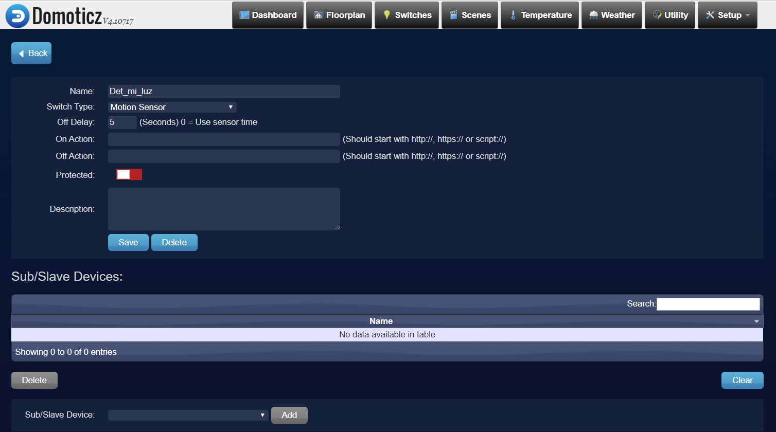

Hello, sorry for my English, I write with the google translator. I have an Aqara human body sensor to activate a scene. The problem is that at the time of deactivating it takes 1.5 minutes. I have configured it in Domoticz to do it in 5 seconds, but it does not and in the log it tells me this:
2019-12-10 19:59:09.992 (Detectores Xiaomi) onCommand: Off, level (0) Color:
2019-12-10 19:59:09.993 (Detectores Xiaomi) Update command has not been implemented for device "Det_mi_luz"

Yes, since I leave the room the motion sensor takes 1.5 minutes to turn off the light. I just wanted the disconnection time to be shorter to save on the bill

MikiG wrote: Tuesday 10 December 2019 23:02 What I want is that while there is movement in the room, the light is on, but if it no longer detects movement in 5 or 10 seconds, turn off the light
That''s only possible if your sensor supports that. Most sensors do not send a new 'motion detected' signal during the time that is set for it to stay on. The script I posted will work when sensor send a new 'motion detected signal' within the time set.
