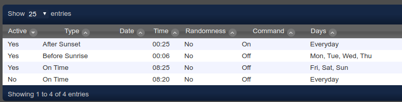

Uhm, probably a silly question but why don't you use the timer function in Domoticz? You could create a group (or several) containing the blinds you want to control. You can then set a timer based on sunset or sunrise or time of day if you like. Only thing the timer can't do is turn of after 8 seconds as per your example.odyseia wrote: Saturday 02 November 2019 11:27 Hello folks,
I have a few blinds which I can set manually via Domoticz. I'm trying for a few days now to set up an event for automation via blockly, but unfortunately it doesn't work. And I cannot understand why. Is there somebody who can help me? Thank you in advance.
Edit: Picture to explain:
Greetz,
Sjonnie
