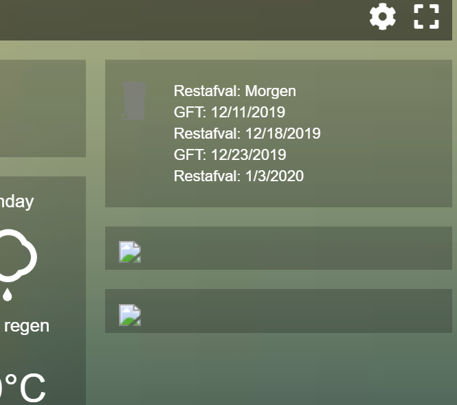

New user to dashticz and loving the software so far. I am having trouble getting the buienradar button picture to show and also the moon phase is not showing. I get the following result:
2019-12-03 21_22_04-Mail.png (57.79 KiB) Viewed 471 times
The garbage is showing, but both the buienradar and the moon are failing.

What version of Dashticz are you using?
For the latest beta you need to use btnimage See: https://dashticz.readthedocs.io/en/beta ... parameters

I am using the latest beta. Thanx for the tip, i totally missed the part about btnimage. I will try that once i get home this afternoon.
