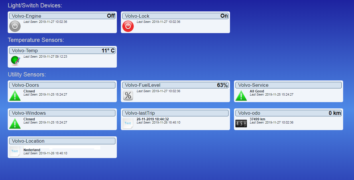

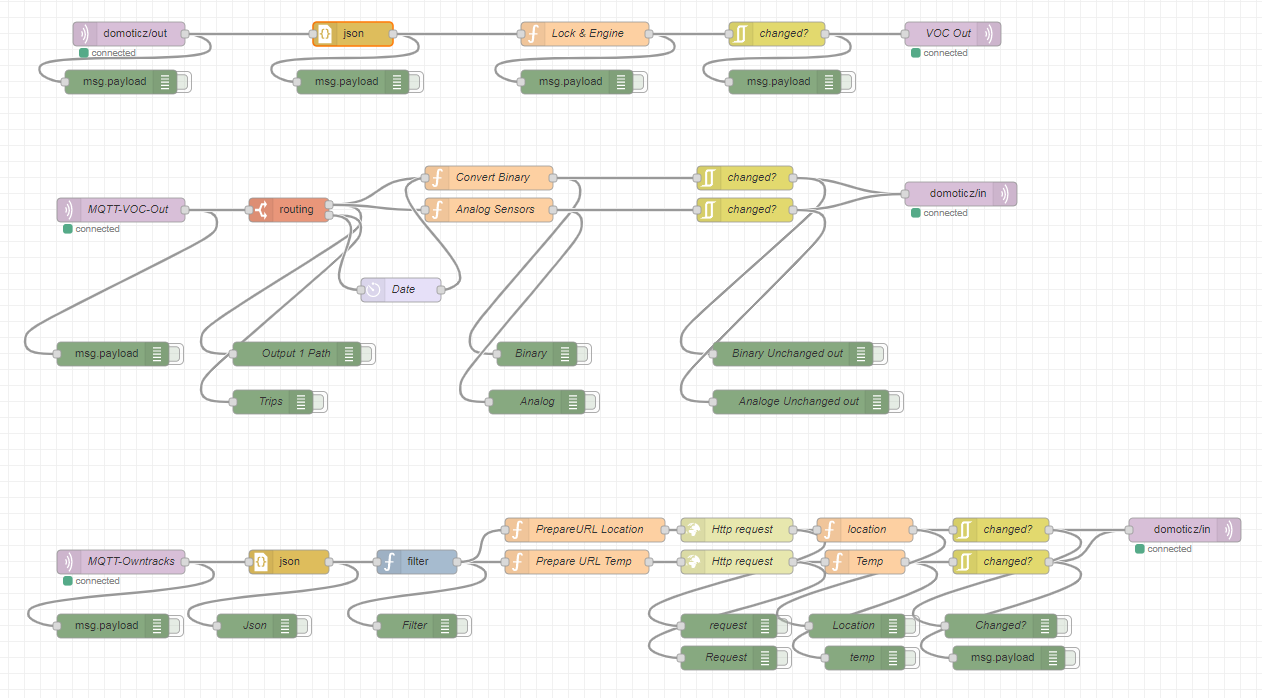

A small update on where I ended up with. (Kudos to FireWizard).
Domoticz setup:
Node red flow:
below (inside the spoiler text) the node red export.
[{"id":"494c88d0.ac5ca8","type":"tab","label":"Flow 1","disabled":false,"info":""},{"id":"112d2046.4bd2d","type":"mqtt in","z":"494c88d0.ac5ca8","name":"MQTT-VOC-Out","topic":"volvo/aplate1/+/+/state","qos":"2","datatype":"auto","broker":"6fc03d79.ef77e4","x":200,"y":340,"wires":[["f9d2f0b4.efa2","b723d201.f91a5"]]},{"id":"f9d2f0b4.efa2","type":"debug","z":"494c88d0.ac5ca8","name":"","active":false,"tosidebar":true,"console":false,"tostatus":false,"complete":"false","x":190,"y":520,"wires":[]},{"id":"b723d201.f91a5","type":"routing","z":"494c88d0.ac5ca8","name":"","rules":[{"v":"volvo/aplate1/*path"},{"v":"volvo/aplate1/sensor/trips/state"}],"outputs":2,"x":410,"y":340,"wires":[["4977b31d.c07c4c","5d6d2da8.df0b84","62d08b26.226364"],["82f1fe41.21d95","42b75197.a8f48"]]},{"id":"4977b31d.c07c4c","type":"debug","z":"494c88d0.ac5ca8","name":"Output 1 Path","active":false,"tosidebar":true,"console":false,"tostatus":false,"complete":"payload","targetType":"msg","x":420,"y":520,"wires":[]},{"id":"82f1fe41.21d95","type":"debug","z":"494c88d0.ac5ca8","name":"Trips","active":false,"tosidebar":true,"console":false,"tostatus":false,"complete":"payload","targetType":"msg","x":390,"y":580,"wires":[]},{"id":"5d6d2da8.df0b84","type":"function","z":"494c88d0.ac5ca8","name":"Convert Binary","func":"// Function node for Binary Sensors\n// Declare variables\nvar number_plate = \"aplate1\";\n// Binary Sensors which will give alert\nif (msg.topic == \"volvo/\" + number_plate + \"/binary_sensor/any_door_open/state\"){\nif (msg.payload == \"close\") {\nmsg.payload = {\"command\":\"udevice\",\"idx\":902,\"nvalue\":1,\"svalue\":\"Closed\"};\n} else {\nmsg.payload = {\"command\":\"udevice\",\"idx\":902,\"nvalue\":4,\"svalue\":\"Open\"};\n}\nreturn msg;\n}\nif (msg.topic == \"volvo/\" + number_plate + \"/binary_sensor/any_window_open/state\"){\nif (msg.payload == \"close\") {\nmsg.payload = {\"command\":\"udevice\",\"idx\":903,\"nvalue\":1,\"svalue\":\"Closed\"};\n} else {\nmsg.payload = {\"command\":\"udevice\",\"idx\":903,\"nvalue\":4,\"svalue\":\"Open\"};\n}\nreturn msg;\n}\nif (msg.topic == \"volvo/\" + number_plate + \"/binary_sensor/service_warning_status/state\"){\nif (msg.payload == \"safe\") {\nmsg.payload = {\"command\":\"udevice\",\"idx\":904,\"nvalue\":1,\"svalue\":\"All Good\"};\n} else {\nmsg.payload = {\"command\":\"udevice\",\"idx\":904,\"nvalue\":4,\"svalue\":\"Service required\"};\n}\nreturn msg;\n}\n// Binary Sensors as switch\nif (msg.topic == \"volvo/\" + number_plate + \"/binary_sensor/is_engine_running/state\"){\nif (msg.payload == \"off\") {\nmsg.payload = {\"command\":\"udevice\",\"idx\":905,\"nvalue\":0,\"svalue\":\"Off\"};\n} else {\nmsg.payload = {\"command\":\"udevice\",\"idx\":905,\"nvalue\":1,\"svalue\":\"On\"};\n}\nreturn msg;\n}\nif (msg.topic == \"volvo/\" + number_plate + \"/lock/lock/state\"){\nif (msg.payload == \"lock\") {\nmsg.payload = {\"command\":\"udevice\",\"idx\":906,\"nvalue\":1,\"svalue\":\"Locked\"};\n} else {\nmsg.payload = {\"command\":\"udevice\",\"idx\":906,\"nvalue\":0,\"svalue\":\"Unlocked\"};\n}\nreturn msg;\n}\nif (msg.topic == \"volvo/\" + number_plate + \"/sensor/trips/state\"){\nmsg.payload = {\"command\":\"udevice\",\"idx\":908,\"nvalue\":0,\"svalue\":(msg.payload)};\nreturn msg;\n}","outputs":1,"noerr":0,"x":660,"y":300,"wires":[["e226c51c.731b88","7c7bc71c.2d6bc8"]]},{"id":"7c7bc71c.2d6bc8","type":"rbe","z":"494c88d0.ac5ca8","name":"changed?","func":"rbe","gap":"","start":"","inout":"out","property":"payload","x":980,"y":300,"wires":[["f75a77e4.c36508","b07bb985.99f4c8"]]},{"id":"e226c51c.731b88","type":"debug","z":"494c88d0.ac5ca8","name":"Binary","active":false,"tosidebar":true,"console":false,"tostatus":false,"complete":"payload","targetType":"msg","x":720,"y":520,"wires":[]},{"id":"f75a77e4.c36508","type":"mqtt out","z":"494c88d0.ac5ca8","name":"","topic":"domoticz/in","qos":"","retain":"","broker":"6fc03d79.ef77e4","x":1250,"y":320,"wires":[]},{"id":"62d08b26.226364","type":"function","z":"494c88d0.ac5ca8","name":"Analog Sensors","func":"// Function node for Analog Sensors\n// Declare variables\nvar number_plate = \"aplate1\";\n// Sensors Analogue values\nif (msg.topic == \"volvo/\" + number_plate + \"/sensor/odometer/state\"){\nmsg.payload = {\"command\":\"udevice\",\"idx\":909,\"nvalue\":0,\"svalue\":(msg.payload)};\nreturn msg;\n}\nif (msg.topic == \"volvo/\" + number_plate + \"/sensor/fuel_amount_level/state\"){\n msg.payload = {\"command\":\"udevice\",\"idx\":910,\"nvalue\":0,\"svalue\":(msg.payload)};return msg;\n}","outputs":1,"noerr":0,"x":660,"y":340,"wires":[["c706b2d8.fd47d","88c07e9d.c0b4"]]},{"id":"c706b2d8.fd47d","type":"debug","z":"494c88d0.ac5ca8","name":"Analog","active":false,"tosidebar":true,"console":false,"tostatus":false,"complete":"payload","targetType":"msg","x":720,"y":580,"wires":[]},{"id":"b07bb985.99f4c8","type":"debug","z":"494c88d0.ac5ca8","name":"Binary Unchanged out","active":false,"tosidebar":true,"console":false,"tostatus":false,"complete":"payload","targetType":"msg","x":1040,"y":520,"wires":[]},{"id":"42b75197.a8f48","type":"moment","z":"494c88d0.ac5ca8","name":"Date","topic":"","input":"","inputType":"msg","inTz":"Europe/Amsterdam","adjAmount":0,"adjType":"days","adjDir":"add","format":"DD-MM-YYYY HH:mm:ss","locale":"en_US","output":"","outputType":"msg","outTz":"Europe/Amsterdam","x":550,"y":440,"wires":[["5d6d2da8.df0b84"]]},{"id":"14521bb3.8170d4","type":"mqtt out","z":"494c88d0.ac5ca8","name":"VOC Out","topic":"","qos":"","retain":"","broker":"6fc03d79.ef77e4","x":1240,"y":120,"wires":[]},{"id":"bace919a.3528f","type":"debug","z":"494c88d0.ac5ca8","name":"","active":false,"tosidebar":true,"console":false,"tostatus":false,"complete":"payload","targetType":"msg","x":200,"y":180,"wires":[]},{"id":"c947644b.4c0608","type":"mqtt in","z":"494c88d0.ac5ca8","name":"","topic":"domoticz/out","qos":"2","datatype":"auto","broker":"6fc03d79.ef77e4","x":210,"y":120,"wires":[["bace919a.3528f","5be29676.03fbd8"]]},{"id":"5be29676.03fbd8","type":"json","z":"494c88d0.ac5ca8","name":"","property":"payload","action":"","pretty":true,"x":490,"y":120,"wires":[["f89aff0f.b81f6","5fae9627.af13f8"]]},{"id":"f89aff0f.b81f6","type":"debug","z":"494c88d0.ac5ca8","name":"","active":false,"tosidebar":true,"console":false,"tostatus":false,"complete":"false","x":490,"y":180,"wires":[]},{"id":"5fae9627.af13f8","type":"function","z":"494c88d0.ac5ca8","name":"Lock & Engine","func":"// Declare variables\nvar number_plate = \"aplate1\";\n// Lock\nif (msg.payload.idx == \"906\") {\nmsg.topic = \"volvo/\" + number_plate + \"/lock/lock/cmd\";\nif (msg.payload.nvalue == 1) {\nmsg.payload = \"lock\";\n}else{\nmsg.payload = \"unlock\";\n}\nreturn msg;\n}\nif (msg.payload.idx == \"905\") {\nmsg.topic = \"volvo/\" + number_plate + \"/switch/is_engine_running/cmd\";\nif (msg.payload.nvalue == 1) {\nmsg.payload = \"on\";\n}else{\nmsg.payload = \"off\";\n}\nreturn msg;\n}","outputs":1,"noerr":0,"x":780,"y":120,"wires":[["f218c8c6.484ed8","5c1f2969.be8e78"]]},{"id":"f218c8c6.484ed8","type":"debug","z":"494c88d0.ac5ca8","name":"","active":false,"tosidebar":true,"console":false,"tostatus":false,"complete":"false","x":770,"y":180,"wires":[]},{"id":"9b500cef.3ffa4","type":"debug","z":"494c88d0.ac5ca8","name":"","active":false,"tosidebar":true,"console":false,"tostatus":false,"complete":"false","x":190,"y":860,"wires":[]},{"id":"1762d8fa.9239f7","type":"mqtt in","z":"494c88d0.ac5ca8","name":"MQTT-Owntracks","topic":"owntracks/volvo/aplate1","qos":"2","datatype":"auto","broker":"6fc03d79.ef77e4","x":200,"y":780,"wires":[["9b500cef.3ffa4","2eac10ca.b94af"]]},{"id":"2eac10ca.b94af","type":"json","z":"494c88d0.ac5ca8","name":"","property":"payload","action":"","pretty":true,"x":410,"y":780,"wires":[["af3d7902.773f88","f508d06f.c8d3c"]]},{"id":"af3d7902.773f88","type":"debug","z":"494c88d0.ac5ca8","name":"Json","active":false,"tosidebar":true,"console":false,"tostatus":false,"complete":"payload","targetType":"msg","x":370,"y":860,"wires":[]},{"id":"5c1f2969.be8e78","type":"rbe","z":"494c88d0.ac5ca8","name":"changed?","func":"rbe","gap":"","start":"","inout":"out","property":"payload","x":1020,"y":120,"wires":[["ad958743.a273a8","14521bb3.8170d4"]]},{"id":"ad958743.a273a8","type":"debug","z":"494c88d0.ac5ca8","name":"","active":false,"tosidebar":true,"console":false,"tostatus":false,"complete":"false","x":1030,"y":180,"wires":[]},{"id":"88c07e9d.c0b4","type":"rbe","z":"494c88d0.ac5ca8","name":"changed?","func":"rbe","gap":"","start":"","inout":"out","property":"payload","x":980,"y":340,"wires":[["f75a77e4.c36508","6f7966df.8dbeb8"]]},{"id":"6f7966df.8dbeb8","type":"debug","z":"494c88d0.ac5ca8","name":"Analoge Unchanged out","active":false,"tosidebar":true,"console":false,"tostatus":false,"complete":"payload","targetType":"msg","x":1050,"y":580,"wires":[]},{"id":"f508d06f.c8d3c","type":"filter","z":"494c88d0.ac5ca8","name":"","property":"payload._type","propertyType":"msg","asArray":false,"itemProperty":"","itemPropertyType":"item","rules":[{"t":"eq","v":"location","vt":"str","output":1}],"checkall":"true","outputs":1,"x":570,"y":780,"wires":[["16d04d4f.1613f3","1b12a286.8de45d","a2acb03b.6c449"]]},{"id":"16d04d4f.1613f3","type":"debug","z":"494c88d0.ac5ca8","name":"Filter","active":false,"tosidebar":true,"console":false,"tostatus":false,"complete":"payload","targetType":"msg","x":570,"y":860,"wires":[]},{"id":"e09061a6.69cce","type":"http request","z":"494c88d0.ac5ca8","name":"Http request","method":"GET","ret":"obj","paytoqs":false,"url":"","tls":"","persist":false,"proxy":"","authType":"","x":970,"y":780,"wires":[["b10eecd5.8892c","e1c71c62.8192b"]]},{"id":"1b12a286.8de45d","type":"function","z":"494c88d0.ac5ca8","name":"Prepare URL Temp","func":"var url = \"https://weather.api.here.com/weather/1. ... on\";\nvar prod = \"observation\";\nvar app_id = \"V------------------------------E\";\nvar app_code = \"M------------------------------Q\";\nvar newUrl = { url: url + \"?product=\" + prod + \"&latitude=\" + msg.payload.lat + \"&longitude=\" +\nmsg.payload.lon + \"&oneobservation=true&app_id=\" + app_id + \"&app_code=\" + app_code};\nreturn newUrl;","outputs":1,"noerr":0,"x":770,"y":780,"wires":[["e09061a6.69cce"]]},{"id":"b10eecd5.8892c","type":"function","z":"494c88d0.ac5ca8","name":"Temp","func":"msg.payload =\n{\"command\":\"udevice\",\"idx\":920,\"nvalue\":0,\"svalue\":parseFloat(msg.payload.observations.location[0].\nobservation[0].temperature).toFixed(0)};\nreturn msg;","outputs":1,"noerr":0,"x":1130,"y":780,"wires":[["20e53bfa.b81314","e4ff4be4.628ea8"]]},{"id":"6818132b.45397c","type":"debug","z":"494c88d0.ac5ca8","name":"request","active":false,"tosidebar":true,"console":false,"tostatus":false,"complete":"payload","targetType":"msg","x":960,"y":860,"wires":[]},{"id":"f8067de9.3f914","type":"mqtt out","z":"494c88d0.ac5ca8","name":"","topic":"domoticz/in","qos":"","retain":"","broker":"6fc03d79.ef77e4","x":1530,"y":740,"wires":[]},{"id":"20e53bfa.b81314","type":"debug","z":"494c88d0.ac5ca8","name":"temp","active":false,"tosidebar":true,"console":false,"tostatus":false,"complete":"payload","targetType":"msg","x":1130,"y":900,"wires":[]},{"id":"e4ff4be4.628ea8","type":"rbe","z":"494c88d0.ac5ca8","name":"changed?","func":"rbe","gap":"","start":"","inout":"out","property":"payload","x":1300,"y":780,"wires":[["f8067de9.3f914","8995bf88.56429"]]},{"id":"6bf661cb.ca5d3","type":"debug","z":"494c88d0.ac5ca8","name":"Changed?","active":false,"tosidebar":true,"console":false,"tostatus":false,"complete":"payload","targetType":"msg","x":1300,"y":860,"wires":[]},{"id":"a2acb03b.6c449","type":"function","z":"494c88d0.ac5ca8","name":"PrepareURL Location","func":"var url = \"https://reverse.geocoder.api.here.com/6 ... on\";\nvar mode = \"retrieveAddresses\";\nvar app_id = \"VYitmwS5PaBmwrY3j0yE\";\nvar app_code = \"MssIhmLd01HWIGqQ6RCEHQ\";\nvar newUrl = { url: url + \"?prox=\" + msg.payload.lat + \"%2C\" + msg.payload.lon + \"%2C\" + \"10\" +\n\"&mode=\" + mode + \"&maxresults=1&gen=9\" + \"&app_id=\" + app_id + \"&app_code=\" + app_code};\nreturn newUrl;","outputs":1,"noerr":0,"x":780,"y":740,"wires":[["d8f7feaf.9ae37"]]},{"id":"d8f7feaf.9ae37","type":"http request","z":"494c88d0.ac5ca8","name":"Http request","method":"GET","ret":"obj","paytoqs":false,"url":"","tls":"","persist":false,"proxy":"","authType":"","x":970,"y":740,"wires":[["bd893963.57fbc8","6818132b.45397c"]]},{"id":"bd893963.57fbc8","type":"function","z":"494c88d0.ac5ca8","name":"location","func":"msg.payload = {\"command\":\"udevice\",\"idx\":921,\"nvalue\":0,\"svalue\":\n(msg.payload.Response.View[0].Result[0].Location.Address.Label)};\nreturn msg","outputs":1,"noerr":0,"x":1130,"y":740,"wires":[["e219dc4a.bf6a2","f64c55cf.44e988"]]},{"id":"e219dc4a.bf6a2","type":"rbe","z":"494c88d0.ac5ca8","name":"changed?","func":"rbe","gap":"","start":"","inout":"out","property":"payload","x":1300,"y":740,"wires":[["f8067de9.3f914","6bf661cb.ca5d3"]]},{"id":"f64c55cf.44e988","type":"debug","z":"494c88d0.ac5ca8","name":"Location","active":false,"tosidebar":true,"console":false,"tostatus":false,"complete":"payload","targetType":"msg","x":1120,"y":860,"wires":[]},{"id":"8995bf88.56429","type":"debug","z":"494c88d0.ac5ca8","name":"","active":false,"tosidebar":true,"console":false,"tostatus":false,"complete":"false","x":1310,"y":900,"wires":[]},{"id":"e1c71c62.8192b","type":"debug","z":"494c88d0.ac5ca8","name":"Request","active":false,"tosidebar":true,"console":false,"tostatus":false,"complete":"payload","targetType":"msg","x":960,"y":900,"wires":[]},{"id":"6fc03d79.ef77e4","type":"mqtt-broker","z":"","name":"LocalhostMqtt","broker":"localhost","port":"1883","clientid":"testing","usetls":false,"compatmode":false,"keepalive":"60","cleansession":true,"birthTopic":"","birthQos":"0","birthPayload":"","closeTopic":"","closeQos":"0","closePayload":"","willTopic":"","willQos":"0","willPayload":""}]
Evert

Hello Evert,
Looks good, if this is, at least, what you wanted. :D
Not every sensor is included, but that is up to every user.
I have two comments and both are regarding the position in the flow of the RBE node.
1. In the second flow, starting with MQTT-VoC-Out, I see, that you have, after the Analog Sensors function node, a RBE node, before you go to domoticz/in. Sensors in Domoticz have a time-out. This time-out, you can configure in "Setup" => "Settings" => "Other". There you will find a configuration option, called "Sensor Timeout". I have configured 7200, which means 5 days.
If you do not update a sensor before the timeout is reached, your sensor will show a red bar at the top, which is meant as a communication error.
Especially two analog sensors are likely to give such an error: Average Speed and Fuel Consumption.
You have them not configured, yet. And, of course, all sensors will give this error, if your car is not in use during this period, e.g. during holidays, if you go by plane.
I experienced that behavior myself, when I had only one function node with the analogue and binary sensors together.
Therefore I made a split.
2.In the third flow, starting with MQTT-Owntracks, you have such a RBE node after location function node.
This means that the location is requested every 5 minutes. Although you have enough credits from HERE, but in my opinion it is useless to request every 5 minutes the location for the same co-ordinates. If you move it to between the filter and "Prepare URL Location, you only ask a new address, if the co-ordinates have been changed.
Questions.
Is it by purpose you chose a counter for the odometer? As the value in now "0".
Do you have comments on the Howto document?

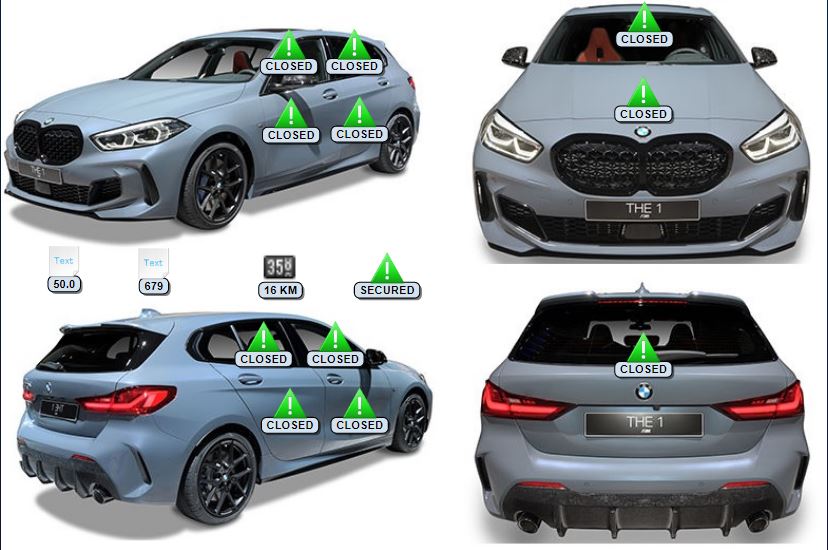

Created the following for fun with Pass2PHP and GitHub help for a connected car.
Pass2php
USB: RFXCom, ZWave, Sonoff 3
MQTT: ZIgbee2MQTT,
ZWAVE: Zwave-JS-UI
Solar: Omnik, PVOutput
Sensors: You name it I got 1.
FireWizard
Posts: 1968
Location: Voorthuizen (NL)
Re: Connected Cars
Post by FireWizard »
The picture looks nice.
Can you tell a little bit more, as this helps other interested users, that owns a BMW.
How do you communicate?
Which help do you refer to?

FireWizard wrote: Wednesday 01 January 2020 21:50 Hi,
Ofcourse.
I started my search at github and found a project called bimmer-connected as this is python based it can be transferred to a Domoticz Plugin. https://github.com/bimmerconnected/bimmer_connected a fellow, maybe former :D Domoticz user @gerard33 seems to be very enthousiastic about this.
pi@raspberrypi:~ $ sudo apt install python3-pip
pi@raspberrypi:~ $ pip3 install bimmer-connected
The script chardetect is installed in '/home/pi/.local/bin' which is not in my PATH.
Also I have Debian Buster installed so 1 extra line is needed.
pi@raspberrypi:~ $ sudo sed -i "s|TLSv1.2|TLSv1.0|g" /etc/ssl/openssl.cnf
After that I was able to extract the first info.
pi@raspberrypi:~ $ /home/pi/.local/bin/bimmerconnected fingerprint USERNAME PASSWORD rest_of_world
pi@raspberrypi:~ $ /home/pi/.local/bin/bimmerconnected status USERNAME PASSWORD rest_of_world
as a result.... a lot of info that can be parsed.
doorDriverFront": "CLOSED",
doorDriverRear": "CLOSED",
doorPassengerFront": "CLOSED",
doorPassengerRear": "CLOSED",
windowDriverFront": "CLOSED",
windowDriverRear": "CLOSED",
windowPassengerFront": "CLOSED",
windowPassengerRear": "CLOSED",
As I work with Pass2PHP I looked for an additional quick start. I found that one:
https://github.com/bluewalk/BMWConnecteDrive, this could be easily integraded with the Pass2PHP approach and needed some lines of code to make it work.

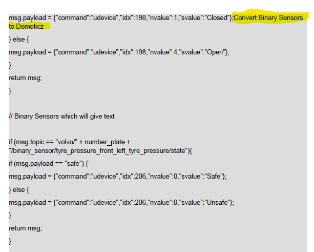

Hi FireWizard
I am making the function node for binary sensors
Om page 14 of your How To ...pdf there is "Convert Binary Sensors to Domoticz"
This is just with one sensor. On all other binary sensors you're not usings this.
Is this text correct or a typo?
regards

Hello Martin,
I assume you mean the first line in the function node?
Every line, starting with // is a comment and does nothing
The complete contents of the function node is:

return msg;
// Binary Sensors which will give text
if (msg.topic == "volvo/" + number_plate + "/binary_sensor/tyre_pressure_front_left_tyre_pressure/state"){
if (msg.payload == "safe") {
msg.payload = {"command":"udevice","idx":206,"nvalue":0,"svalue":"Safe"};
} else {
msg.payload = {"command":"udevice","idx":206,"nvalue":0,"svalue":"Unsafe"};
return msg;
if (msg.topic == "volvo/" + number_plate + "/binary_sensor/tyre_pressure_front_right_tyre_pressure/state"){
msg.payload = {"command":"udevice","idx":207,"nvalue":0,"svalue":"Safe"};
} else {
msg.payload = {"command":"udevice","idx":207,"nvalue":0,"svalue":"Unsafe"};
return msg;
if (msg.topic == "volvo/" + number_plate + "/binary_sensor/tyre_pressure_rear_left_tyre_pressure/state"){
msg.payload = {"command":"udevice","idx":208,"nvalue":0,"svalue":"Safe"};
} else {
msg.payload = {"command":"udevice","idx":208,"nvalue":0,"svalue":"Unsafe"};
return msg;
if (msg.topic == "volvo/" + number_plate + "/binary_sensor/tyre_pressure_rear_right_tyre_pressure/state"){
msg.payload = {"command":"udevice","idx":209,"nvalue":0,"svalue":"Safe"};
} else {
msg.payload = {"command":"udevice","idx":209,"nvalue":0,"svalue":"Unsafe"};
return msg;
if (msg.topic == "volvo/" + number_plate + "/binary_sensor/washer_fluid_level/state"){
msg.payload = {"command":"udevice","idx":218,"nvalue":0,"svalue":"Safe"};
} else {
msg.payload = {"command":"udevice","idx":218,"nvalue":0,"svalue":"Unsafe"};
return msg;
if (msg.topic == "volvo/" + number_plate + "/binary_sensor/brake_fluid/state"){
msg.payload = {"command":"udevice","idx":217,"nvalue":0,"svalue":"Safe"};
} else {
msg.payload = {"command":"udevice","idx":217,"nvalue":0,"svalue":"Unsafe"};
return msg;
if (msg.topic == "volvo/" + number_plate + "/binary_sensor/service_warning_status/state"){
msg.payload = {"command":"udevice","idx":224,"nvalue":0,"svalue":"Safe"};
} else {
msg.payload = {"command":"udevice","idx":224,"nvalue":0,"svalue":"Unsafe"};
return msg;
if (msg.topic == "volvo/" + number_plate + "/binary_sensor/bulb_failures/state"){
msg.payload = {"command":"udevice","idx":226,"nvalue":0,"svalue":"Safe"};
} else {
msg.payload = {"command":"udevice","idx":226,"nvalue":0,"svalue":"Unsafe"};
return msg;
// Binary Sensors not in use
//if (msg.topic == "volvo/" + number_plate + "/binary_sensor/any_door_open/state"){
//if (msg.payload == "close") {
//msg.payload = {"command":"udevice","idx":xxx,"nvalue":1,"svalue":"Closed"};
//} else {
//msg.payload = {"command":"udevice","idx":xxx,"nvalue":4,"svalue":"Open"};
//return msg;
//if (msg.topic == "volvo/" + number_plate + "/binary_sensor/any_window_open/state"){
//msg.payload = {"command":"udevice","idx":yyy,"nvalue":1,"svalue":"Closed"};
//} else {
//msg.payload = {"command":"udevice","idx":yyy,"nvalue":4,"svalue":"Open"};
//return msg;
if (msg.topic == "volvo/" + number_plate + "/binary_sensor/is_engine_running/state"){
if (msg.payload == "off") {
msg.payload = {"command":"udevice","idx":230,"nvalue":0,"svalue":"Off"};
} else {
msg.payload = {"command":"udevice","idx":230,"nvalue":0,"svalue":"On"};
return msg;
if (msg.topic == "volvo/" + number_plate + "/lock/lock/state"){
if (msg.payload == "lock") {
msg.payload = {"command":"udevice","idx":228,"nvalue":0,"svalue":"Locked"};
} else {
msg.payload = {"command":"udevice","idx":228,"nvalue":0,"svalue":"Unlocked"};
return msg;
if (msg.topic == "volvo/" + number_plate + "/switch/heater/state"){
msg.payload = {"command":"udevice","idx":229,"nvalue":0,"svalue":"Off"};
} else {
msg.payload = {"command":"udevice","idx":229,"nvalue":0,"svalue":"On"};
return msg;
if (msg.topic == "volvo/" + number_plate + "/sensor/trips/state"){
msg.payload = {"command":"udevice","idx":227,"nvalue":0,"svalue":(msg.payload)};
return msg;
Perhaps, you can use it, but you have to replace the idx's for your idx's.
And change ABC123 with your number plate.
