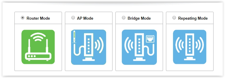

Also I'm going to see if I can reset my NetGear Router following the Ziggo router, ri have these options;
Screen Shot 11-30-19 at 05.06 PM.JPG (79.63 KiB) Viewed 4281 times
Not sure what the options do, but I'll find out.

Be aware that this could potentially be a double NAT problem.
If you have both a Ziggo router and a Netgear router, you need to have the Ziggo router in bridge mode.
Simply said, is you connect your laptop to the Ziggo router, what IP address do you get?
If it is between one of these, you have a double NAT construction and your Ziggo router is NOT in a BRIDGE mode.
These IP addresses are private range IP addresses:
10.0.0.0 – 10.255.255.25
172.16.0.0 – 172.31.255.255
192.168.0.0 – 192.168.255.255
Ziggo will mostly use the IP address 192.168.178.1 for it's router.
That is private range....
This will not work properly with a second Netgear router behind it and results in double NAT...
Best thing you could do is to remove the Netgear router until you have a better understanding of networks.
