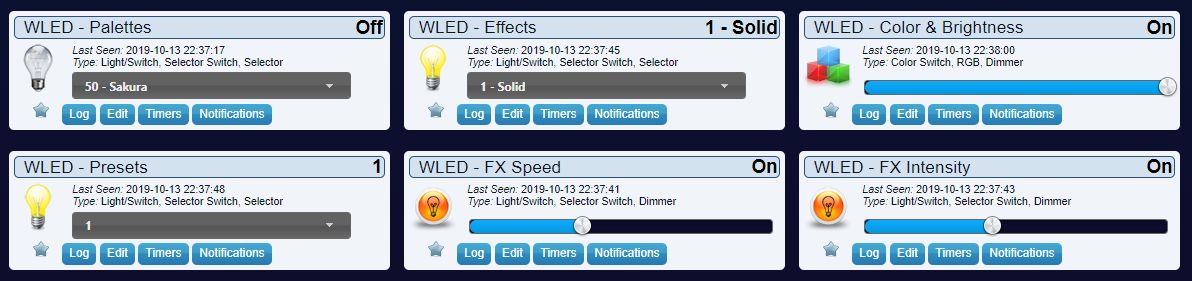

If anyone interested, I've made a Python plugin for WLED integration into Domoticz.
It's the first version and still quite beta, but it works for me. (It's my first Python project and first GitHUB repository).
Curious to know if it works for you.
My plugin: https://github.com/frustreermeneer/domoticz-wled-plugin
I'm planning to extend it, to make full use of all WLED features.
WLED allows you to control RGB LEDs with an ESP8266/ESP32 over WiFi.
WLED: https://github.com/Aircoookie/WLED
Screenshot WLED in Domoticz

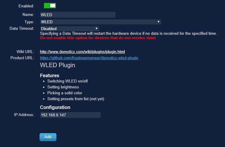

I think you entered the IP address the wrong way.
Try filling out only 192.168.1.98
It should look like something like this:

frustreerMeneer wrote: Tuesday 15 October 2019 22:15 I think you entered the IP address the wrong way.
Hello!
Of course i did wrong :)
I put http://192.168.1.98/ should be 192.168.1.98
Its working great know, thanks for your help!
First ledstrip i got to work with Domoticz !
Realy impressive work you have done!
Thanks again !
//Cluedo

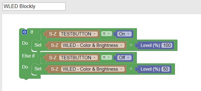

I try to control my WLED with a Nexa 433 Mhz wall switch. I made a Blocky event handler that turn on WLED - Color & Brightness when I press ON and tour off same WLED when I press OFF on my wall switch.
This works but I get this error:
2019-11-25 22:52:28.240 Error: (CDevice_update) WLED - Color & Brightness: Failed to parse parameters: 'nValue', 'sValue', 'Image', 'SignalLevel', 'BatteryLevel', 'Options', 'TimedOut', 'Name', 'TypeName', 'Type', 'Subtype', 'Switchtype', 'Used', 'Description', 'Color' or 'SuppressTriggers' expected.
2019-11-25 22:52:28.240 Error: (WLED) 'CDevice_update' failed 'TypeError':'argument 15 must be str, not dict'.
When I try to dim the device by use the blocky set dim % it doesn't work at all. Maybe I'am using wrong device. I havent used RGB lights before with Domoticz.
I think your plugin is a great idea. It only need some fixes.

Ankan
Posts: 48
Joined: Thursday 09 November 2017 20:07
Re: Python Plugin: WLED
Post by Ankan »
My blocky script is very simple and it looks like this..
If Button = On
	Set WLED = On
Else if Button = Off
	Set WLED = Off
From time to time I get two other errors also
Transport is not connected, write directive to 'getWLEDStatusConn' ignored.
No transport, write directive to 'getWLEDStatusConn' ignored.
The dim problem where a limitations in blocky. You can't check dim level in blocky so I have to do it in Python or something else. The idea is to make the wall switch smart. If you press on it toggle dim level if the strip is already on. Off just switch off the strip.

Ankan wrote: Wednesday 27 November 2019 0:04 My blocky script is very simple and it looks like this..
If Button = On
	Set WLED = On
	Set WLED = Off
I will try to replicate your script to see if i get the same error and hopefully i can fix it then.

frustreerMeneer wrote: Wednesday 27 November 2019 16:35 I will try to replicate your script to see if i get the same error and hopefully i can fix it then.
I made the following script in blockly and it works. Maybe it's because you used ON/OFF in stead of Set Level?
WLED Blockly Example
