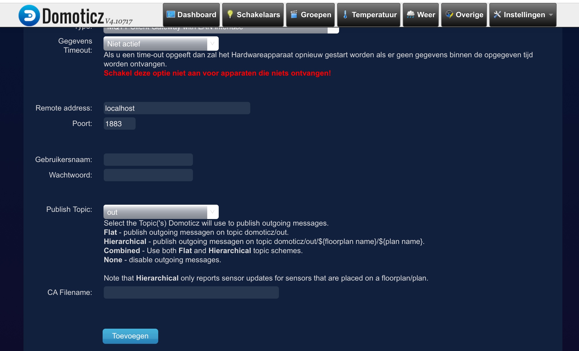

No such option? Please see attached.I do not use a floorplan by the way. Will check what my sniffing results towaaren wrote: Friday 22 November 2019 20:23It shows that domoticz is sending an MQTT message for every device update. If that is intended that's OK but if not you might want to restrict the number of messages.Kranendijk wrote: Friday 22 November 2019 19:11 Does this provide some helpful information? It seems like it polls all devices like in a 10 second interval or so
You can do this by changing the settings of MQTT on the hardware tab of domoticz from Flat or Combined to Hierarchical.
- 3AE6C086-1715-4DEA-8D49-8D00DF8530CF.jpeg (302.52 KiB) Viewed 1825 times
- waaren
- Posts: 6028
Re: Philips HUE errors in Domoticz
out = flatKranendijk wrote: Friday 22 November 2019 22:19 No such option? Please see attached.I do not use a floorplan by the way. Will check what my sniffing results to![]()
/ = hierarchical
out +/ = combined
