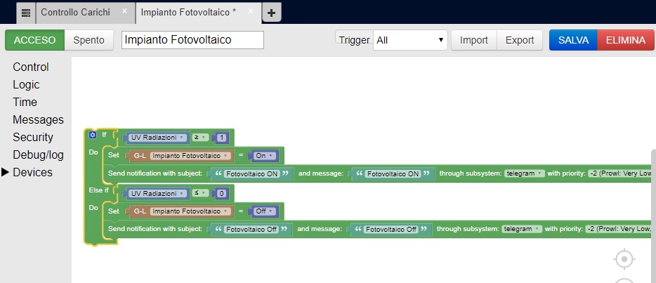

hello excuse me I need help for telegram notifications about switches (in) or rules about blocky: why notices are continually sent to me if the status of a switch does not change?

why domoticz send me notifications of state switch in or out every minutes ?

And what is your rules or blocky ?
Something like if switch == on then send telegram ??
Create some helping variable and store info, that notification was sent.
if switch == on AND varSENT == 0 then send telegram and set varSENT = 1
if switch == off AND varSENT == 1 then send telegram and set varSENT = 0

Hello my blocky is this in image. But i have same problem from switch input or output notifications.
