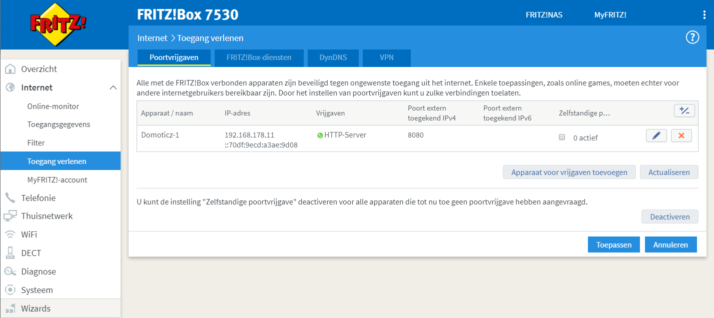

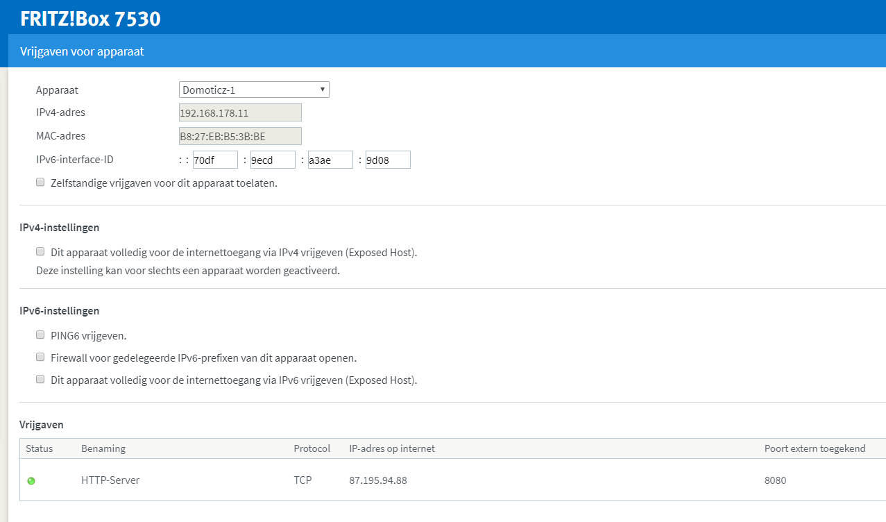

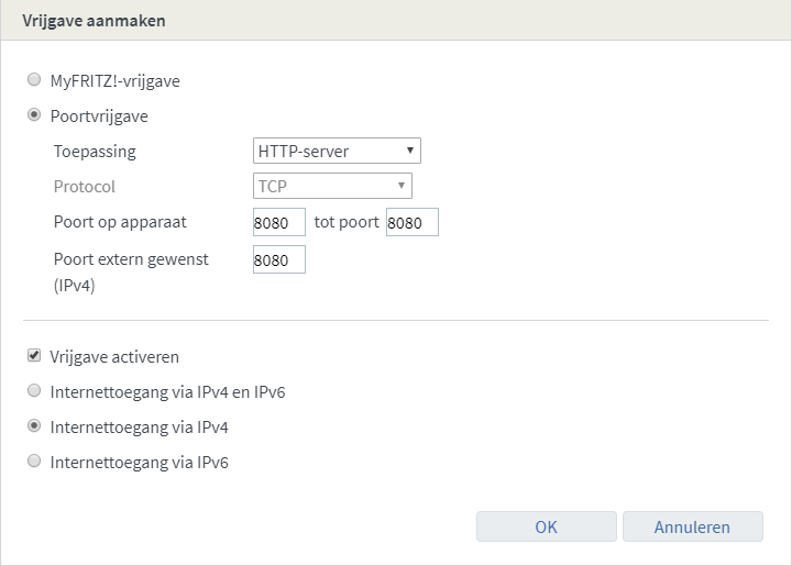

Het betreft versie FRITZ!OS: 07.12
Toegang verlenen.png (59.35 KiB) Viewed 2210 times
Vrijgave aanmaken.png (16.21 KiB) Viewed 2210 times

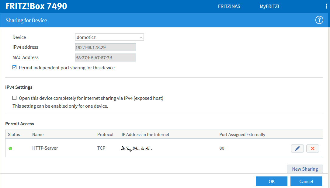

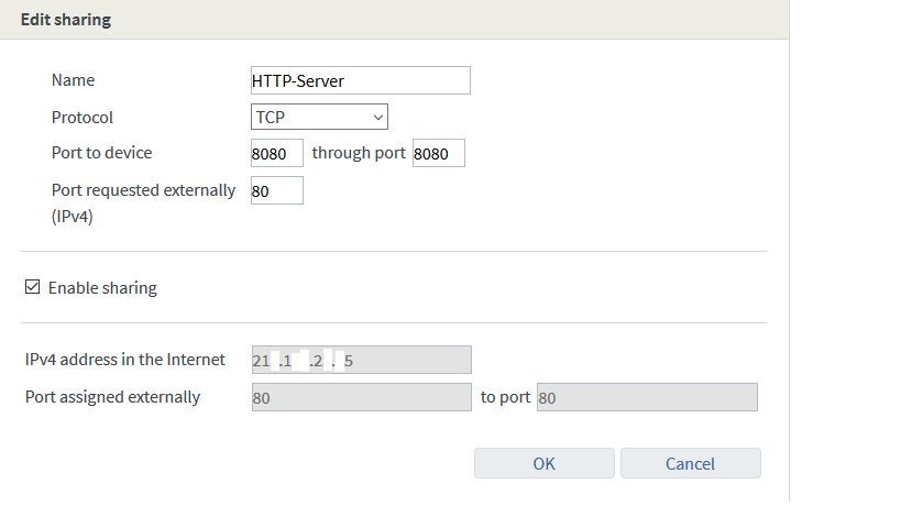

These are my setting on a Fritzbox 7490
Latest version of Domoticz and more running on Docker|Raspberry Pi 4-B 8GB Bookworm|RF-Link|Klik Aan Klik Uit|Nefit easy|ESPeasy|P1 power meter|S0PCM-5 through Ser2Net|Alecto WS5500|FrtizBox|Satel Integra|Solis
Greetz Andre.

I notice that the FRITZ!Box gives the PI also a so called IPv6-interface-ID.
Can that be the problem?
