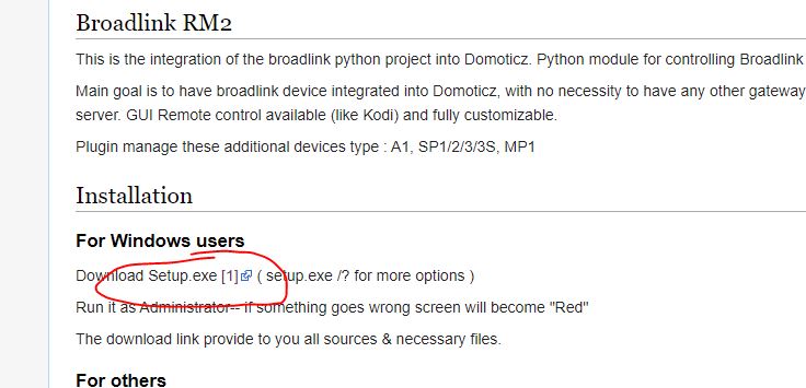

I know that it is stupid but I can`t find setup.exe for the broadlink plugin installation for windows.
https://www.domoticz.com/wiki/Plugins/B ... dows_users

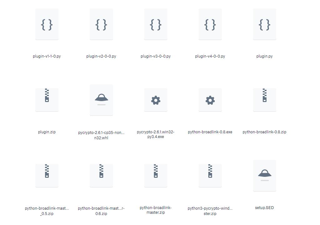

I went there and there is a link that goes to dropbox archive. In there, there is no setup.exe. I downloaded the whole archive as Broadlink.zip , but the same thing (expected of course). What am I missing here? Does anyone have this setup.exe for broadlink plugin on windows?
Any help is much appreciated.

I resolved the problems somehow so to avoid same trial and error for otheres here is the thing:
1. download files from official link
https://www.dropbox.com/sh/htyghey9e402 ... 3H36a?dl=0
on upper right part of page there is download option that you can choose to download all files .
2. Create a Broadlink dir on your c drive.
3. Unzip downloaded files there
4.Create subfolders in that folderlike this: C:\Broadlink\Broadlink\python-broadlink-0.8\python-broadlink-0.8\
(Yes this is exactly right dir structure)
5. Unzip files that I attached to :\Broadlink\Broadlink\python-broadlink-0.8\python-broadlink-0.8\
6.Open CMD as administrator.
7.Go to c:\Broadlink
8. run SetupBroadlink.bat

you're right.
something wrong with dropbox.
Now available again.
thanks!
