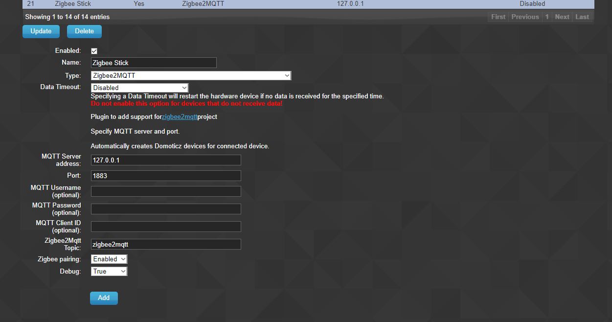

The Configuration within domoticz looks like in the picture below. Can anyone Help me?

- 1.JPG (72.52 KiB) Viewed 1180 times

I have 2 settings different to yours. Don't know if that's the issue, but you could try.
Zigbee pairing: Disabled (i only set this to enable, when i want to add a device)
Debug: false
Debug: false

I already tried changing these setting and left pairing on because I qant to add new devices. Sadly it doesn't make any difference.
